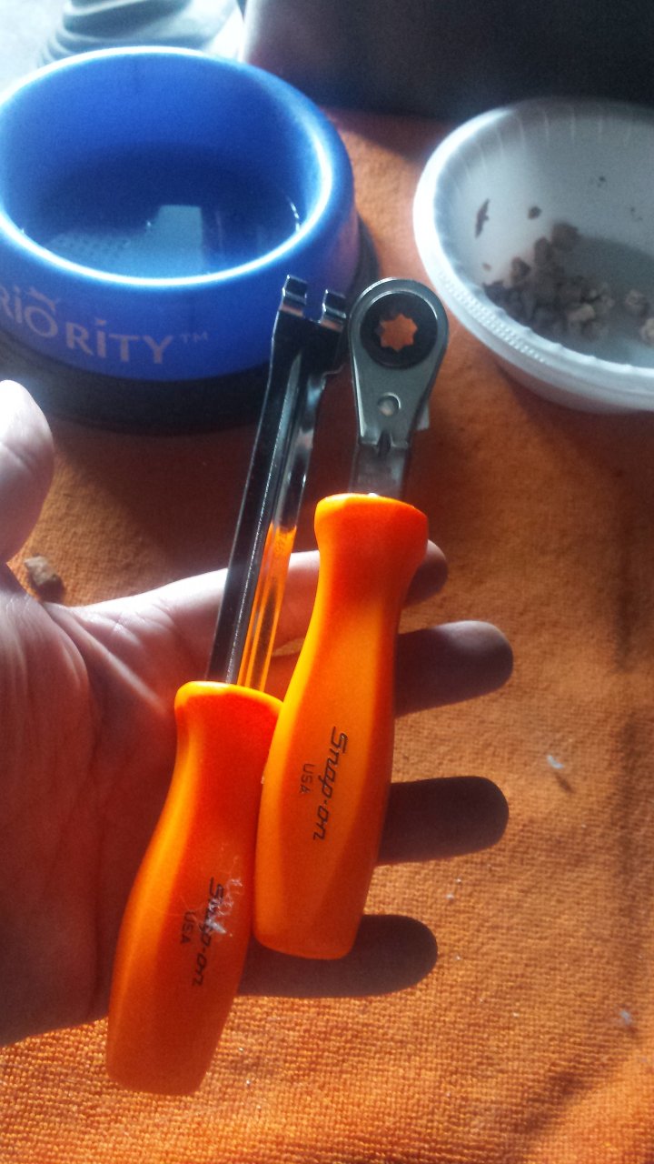

  4. AModelCat
    Joined:
    Messages:
    29,390
    Thanks Received:
    161,299
    Location:
    A ratchet wrench and a cheap pair of side cutters costs about $8.
    Rideandrepair Thanks this.

  6. D.Tibbitt
    Joined:
    Messages:
    22,214
    Thanks Received:
    152,842
    Location:
    I was gonna say go take a look at daves bad ### tools but look like he already took care of u buddy
    Rideandrepair and otterinthewater Thank this.
