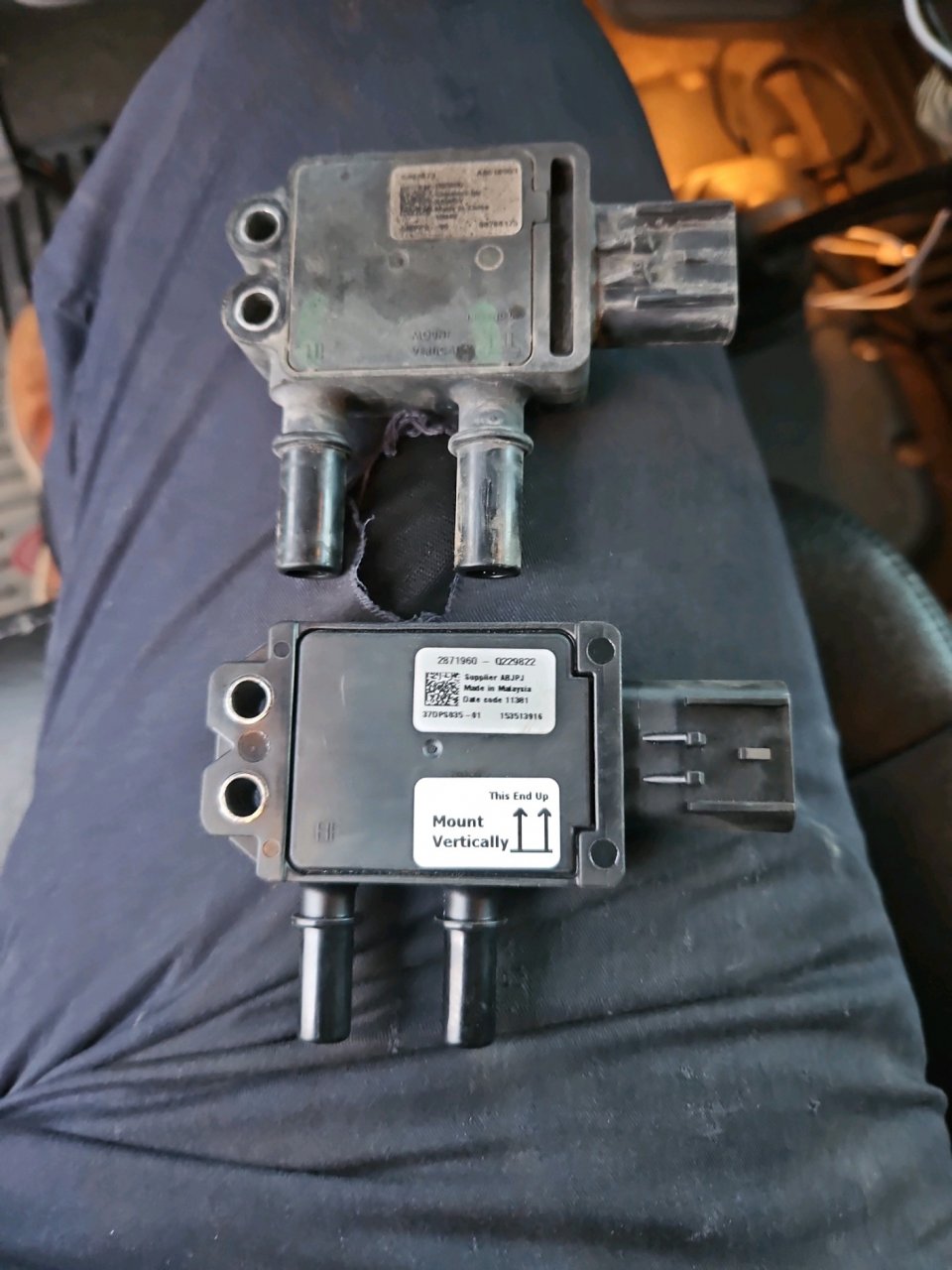

    Ya man I feel ya, like some just mentioned it's possible the DPF pressure sensor is bad. Mine went out on Easter weekend. Normally they get soot/moisture in them, you could try taking that off and taking a paper towel, stuff it in both holes to absorb the moisture... Being a company truck though, might be best to let them handle it...
    How far are you from the house?
    Here is what the DPF pressure sensor looks like, not sure about international but on my Peterbilt its right behind the huge aftertreament filter on the passenger side...
