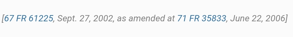

    393.104 hasn't been changed since 2006. It's right in the citation notes at the bottom of that particular section.
    Of particular note is this comment from Kinedyne recommending that "rub rails" be renamed to "securement rails" and given a WLL.
    Federal Register :: Request Access
    This was the FMCSA response to that:
    ECFR is updated almost daily but they do cite the most recent NPRM at the bottom of each specific section that applies to that section.
    The rule of no markings needed for anchor points is indeed from 2002 as noted in the FMCSA response above. It hasn't changed since then. Nowhere in the current laws is there any wording that says any anchor point needs a marked or known WLL.
