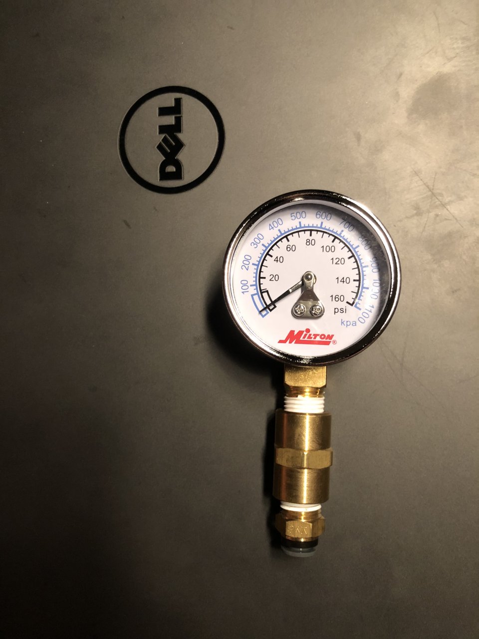

    Buy 4 T's and 4 gauges.
    Mount them permantly.

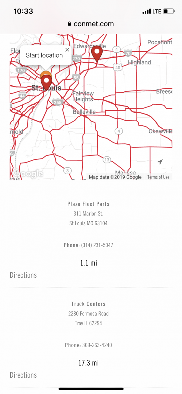

    To check air pressure in your air bags you will need air line of the same size a tee same size and a pressure gauge. Dont cut no air lines. Remove the line from air bag put it in a tee then short piece( 5-10in) from a tee into air bag and long piece(4-5 ft) from gauge into a tee. You can move this set up from bag to bag. I bought this gauge from local shop that sells parts for trucks and tools for shops something like a fleetpride
    Try calling this 2 places

    What gauges do you installed on your truck, maybe got a part number or name of the place where you got them from??Can you post a pictures of how you mount them just very curious of the set up??
