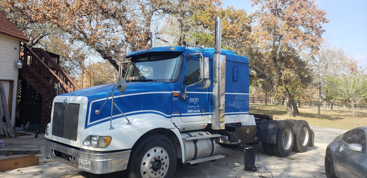

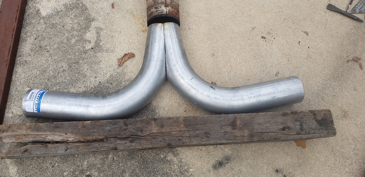

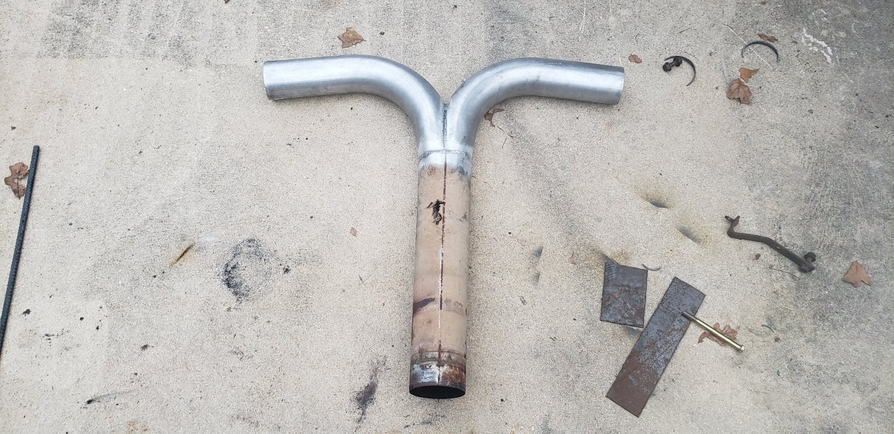

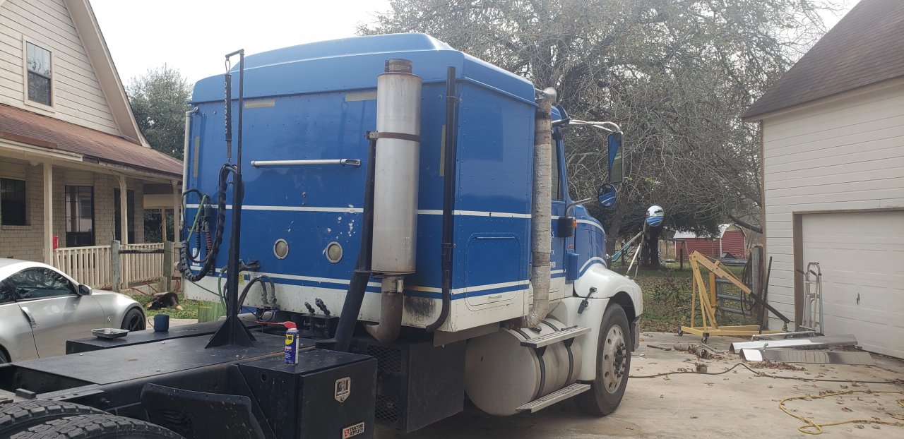

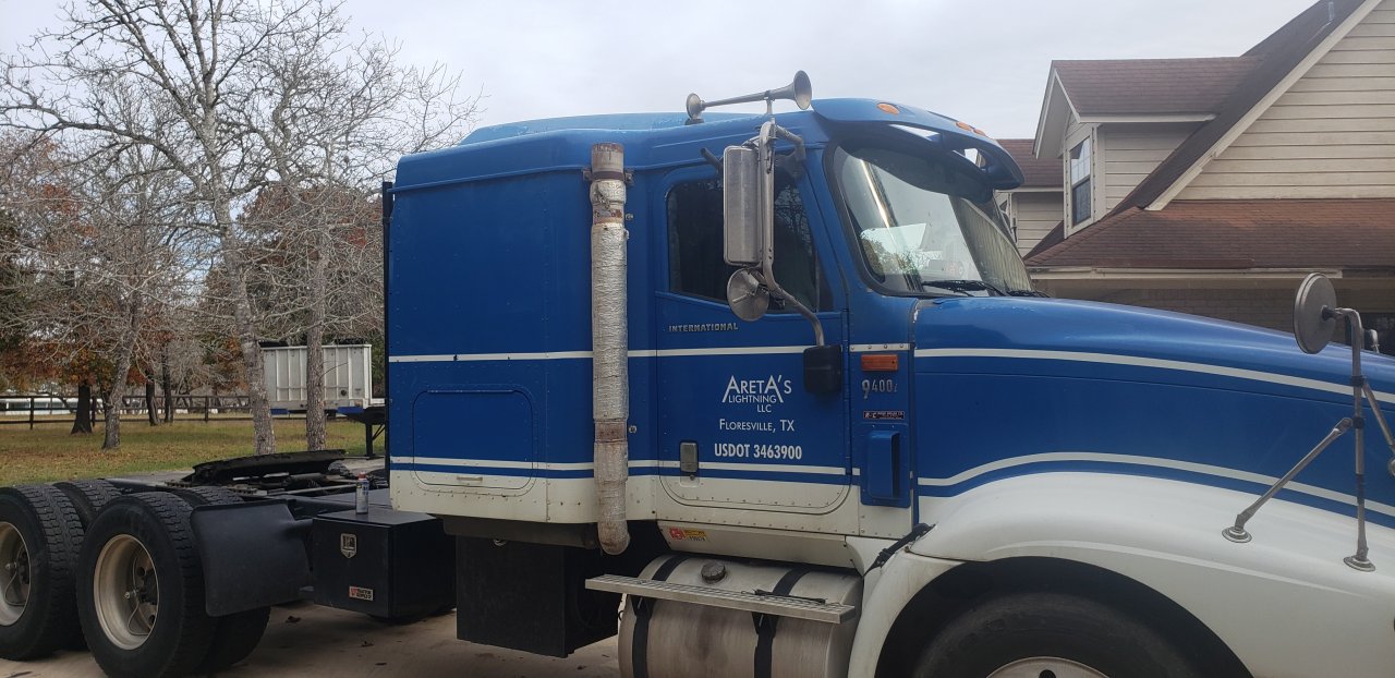

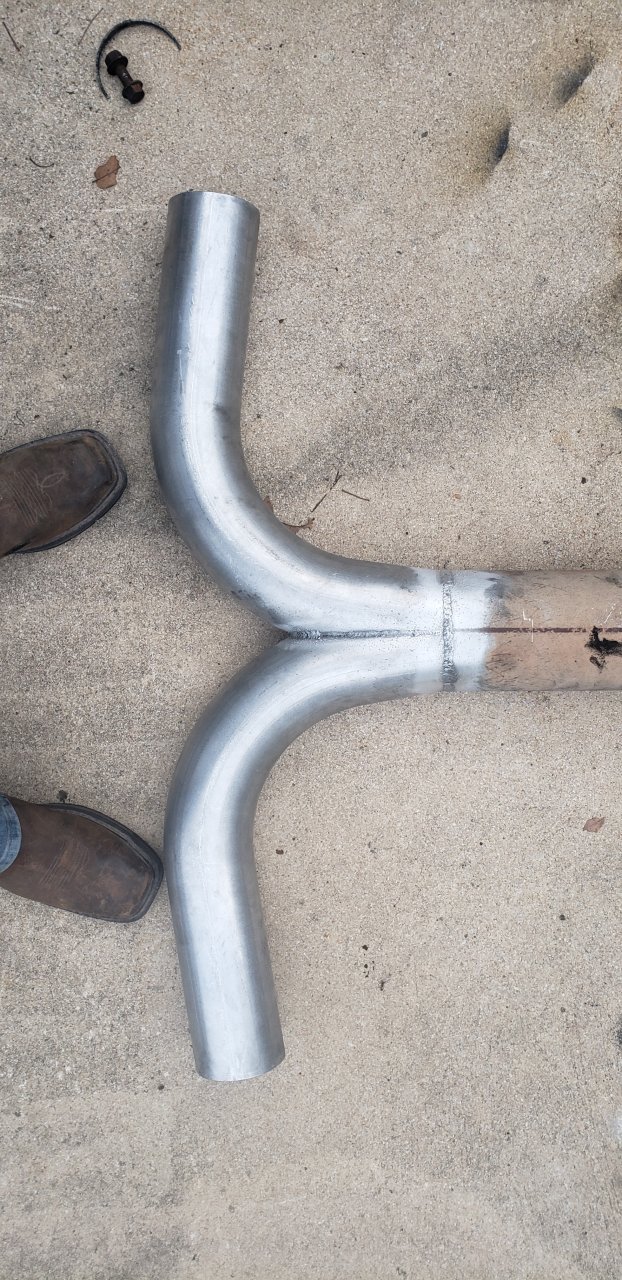

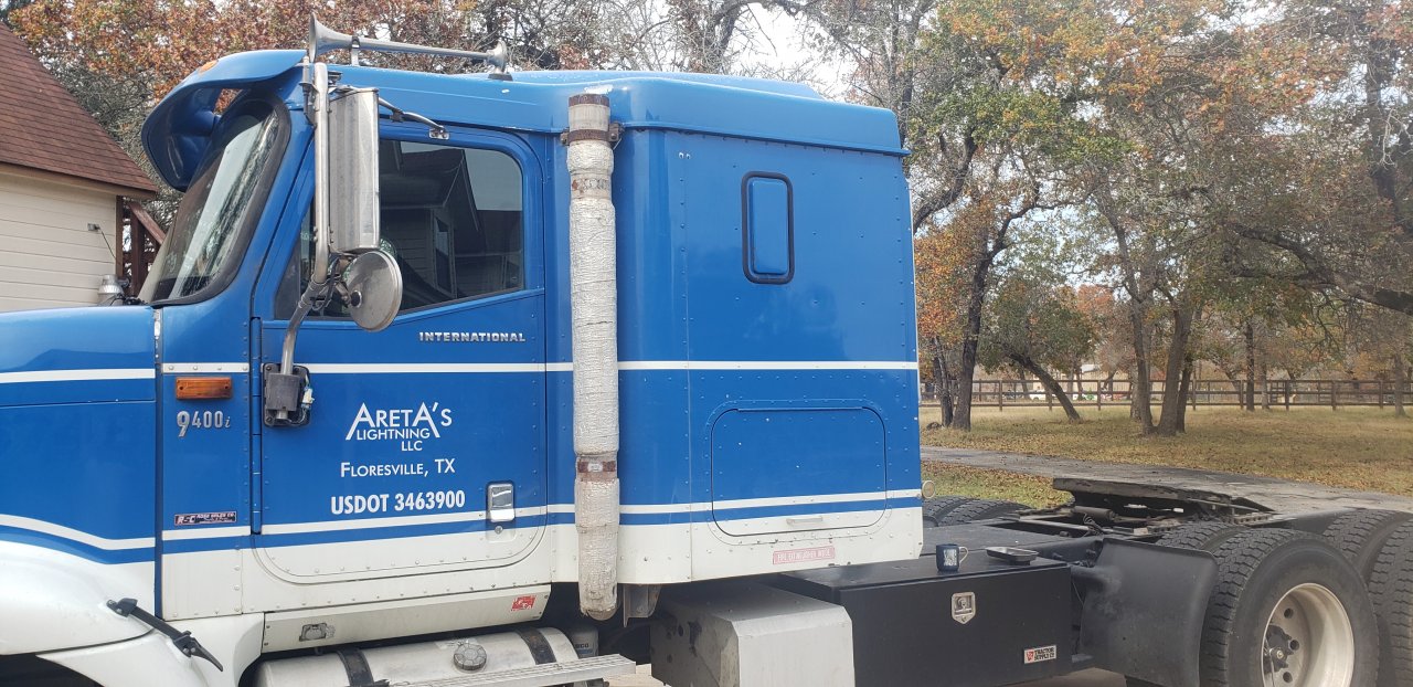

    These stacks are mostly supported from the bottom, as far as weight is concerned. So on top, I used fender washers. There's three bolts, and it's set up to go in a curve, so it's strong. I can't currently weld aluminum, so I couldn't weld in any backing. I did think about making a plate to go back there, but it's not smooth. There's some raised channels. The front bolt goes through several sections of aluminum that ends up being almost a quarter inch thick.

    Your overqualified to drive…… you should sell your fabrication skills…..

    Great job overall, especially the welding, That is a good weld. I'm a Journeyman welder, a has been . Worked with some UA Welders. I do know a great weld when I see one.
    Also, that Rig, they are one tough piece of equipment. Can't wear them out if you keep them maintained.
