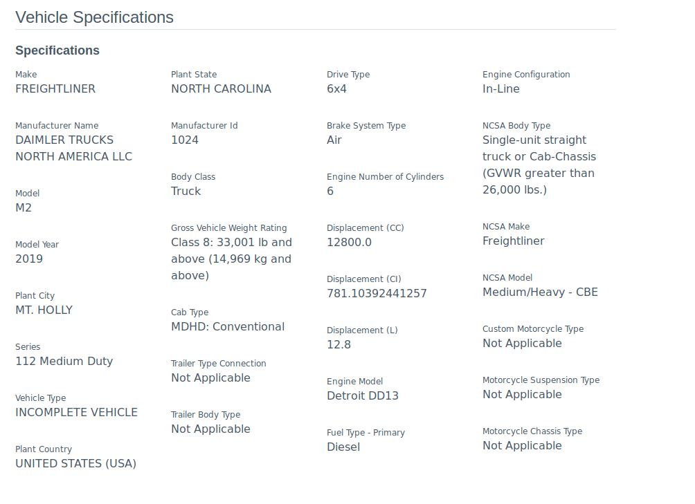

  4. GenerallyTso
    GenerallyTso Bobtail Member
    4
    2
    Jul 7, 2019
    Does this help? I've had trouble finding what the gross weight is. It seems to be the vehicle weight + 30,000 lbs. Those slabs vary in size, but weigh around 1000-1200 apiece, I am new to this industry - I would have thought that if the max load is 30k normally people would haul slightly less than that, especially if going through mountains - or is it normal to carry a max load?

  5. AModelCat
    29,759
    165,351
    Typically in the US tandem drive axles are legal to 34,000 lbs and a steer axle is good to 12,000 lbs. So I could see your payload being 30,000 lbs if your truck is setup that way.
    If the spec sheet you posted is for the truck you drive then you definitely shouldn't need to be shifting 7 gears to get to 25 mph.

  6. MACK E-6
    50,215
    240,300
    Depends how it’s geared. If what he said is actually the case, he may have a top speed of about 60, but climbing a hill should be no problem.
