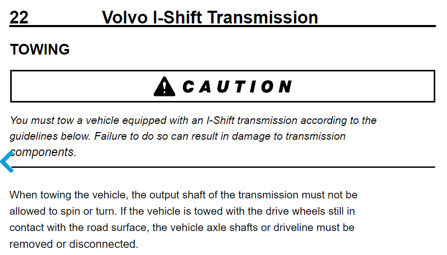

    Oh, I got that. I was just commenting on that particular tow. I think that there may be other issues besides the pump with I-shift if you don't drop the drive shaft

    I wouldn't move one 10 feet without pulling a driveline. IShifts are one of the most sensitive when it comes to towing and I'm not paying for one.

    Thanks for info. Yeah I am gonna guess he messed it up. If I hadn't of been so stressed and pissed waiting 4 hrs in rush hour traffic I would had caught it as I thought I heard this before. Gonna be a big mess I can see coming. I at least have it on video that he admits to pulling it without doing his job right.

    Don’t know what grounds you have but maybe get Volvo involved and make the tow company flip the bill to pull and verify the Tranny is ok
    Or have them agree to a warranty of some sort??

    You can’t tow a truck with an I shift, DT 12 or endurant transmission without pulling drive shaft or axles. Read your owners manual
