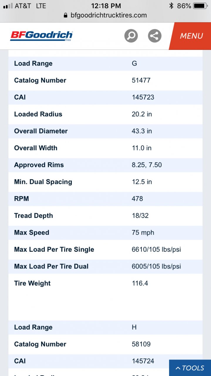

    42E7324E-0B11-435A-A7AA-5C37D4368180.jpeg Don’t know how to do the link deal from my phone,but here the steer tire I run. Looks to be 75mph. I would guess the tire manufacturers have at least a 10% cushion built in.
    wore out and Lepton1 Thank this.

    Bridgestone R283A @ 75 mph.
    Lepton1 Thanks this.
