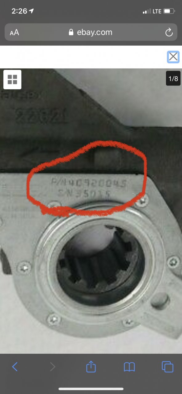

    Oh yea your right I believe the part number actually starts with 400 or 409. But all im finding online is 20221 not 22021. Yeah I found a number online and of course no one is there on the weekend(which I don't need right now anyway, just looking to replace before it gets cold). I found a guide on the Haldex website and still didn't come up with anything

    @spsauerland.... is that 2340 the number for the brake drums? AND THANK YOU VERY MUCH!! And the way I read that is... I can get either 40020231 OR 409-20019 slack adjusters correct?

    Pretty sure all you can get is the kit #, OEM # is only for factory build. The kit will have hardware with it. That number is the BOM (build of materials). I opened it in this screen shot so see original drum P/N. Screenshot_20210919-153424.png
    I wouldn't buy that overpriced drum myself. Brake shoes are FMSI 4709 ESII.

    Can you give me the number for the slack adjuster for steer axle?

    40020225. Kinda surprised a 6", but has 16.5x 5 steer brakes.
