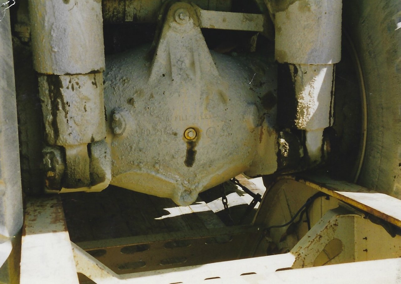

    Found another pic from "back then" that might be interesting. This was how I supported front axles. The ramp on its edge is 3/8 T-1 , I used these when loading track machines over the front to protect the trailer, they were just a little taller than the front edge. Hardwood and some steel plate on top. I think this is a 777.

    Here's the rear axle of a 773 dump up on the neck of my 7 axle, before the 9 axle came along. 1st time I hauled one I did it like the beam guys would. Drove the steer tires up on long blocks, put the neck on then backed it forward up on more blocks under the rear tires to get it as far forward as I could to get under my 60L limit on 6-7.Needed about 6' of 12" high timbers under steer tires to do this.. After a couple times of dragging timbers, I built a "sled" that slid on the 2 center frame rails. The front axle came in contact with it near the front of the trailer and then slid (with the help of a little oil) easily to the rear of the trailer. Steer tires inside guage was about 8'6" so it stayed centered. Easily stayed under 14-6.

    As I recall, the trucks had nitrogen filled struts on the front axle. I got the shops to release the gas from and the wheels stayed up while it was sitting on the sled. Your pic looks just like mine on the 7 axle.
