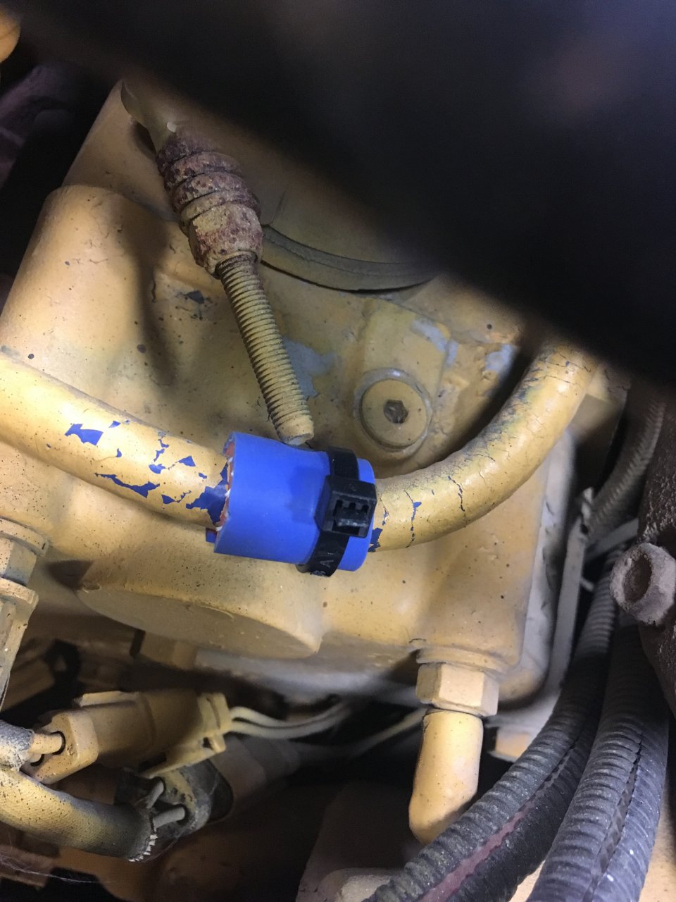

    image.jpeg I caught this hose rubbing on this bolt awhile back before it rubbed all the way through I just put a piece of heater hose with a zip tie.
    Oxbow Thanks this.
