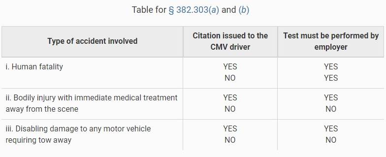

    Splitting hairs, but it is not required in a tow away by law. Only in injuries that require immediate medical attention. In other words, oncoming four wheeler crosses two lanes side swipes you and takes out two drive, two trailer tires and rims and completely totals his brand new Lexus but refuses medical help on scene. Truck driver will not be required to drug test even though both vehicles were towed. Like I said, splitting hairs, but it is not required in a tow away when there is a clear and concise accident report. I know first hand.

    Better check that - 382.303: Post-accident testing
    if either vehicle is towed, there is a drug test.

    Not in my case, and I was pulling for one of the most safety anal companies there is. As soon as the other driver admitted fault and refused medical help on seen I was good. Safety department even asked to speak to the trooper working the scene. Both vehicles were towed. Just telling you how it works in real life in a clear cut case. I was fine with taking a drug test if I had too but was way more worried about the logistics of putting my truck back together. I can check anything you want but I have had it happen twice. I will add that in both cases a state trooper handled the scene and my carrier had the accident report within 30 min. Never had DOT on the scene. Take it as you want.

    Just based on the table that's part of 382.303 the being towed is only true if the driver gets a ticket. Just based on that table the carrier MUST test if there was a fatality. After comment 36 was made I called a friend who is a retired DOT cop. I left a VM, maybe he will call me back soon.
    The text to 382.303 can be confusing, but that table is clear.
