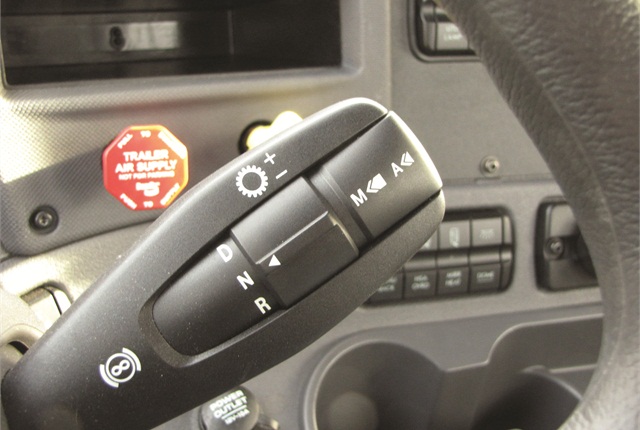

    Can you post a picture of the shift lever?
    If it's like this one (I think most newer freightliners), the center part with the A and M is a push button to toggle between auto (A) and manual (M) mode. Once in manual mode, flipping the lever up/down (like the turn signal lever) will shift up and down.
    tinytim, Cattleman84 and expedite_it Thank this.

    I cannot post a picture of the shift lever right now because the mechanics are working on it, and I am not allowed to go inside the truck right now. But my shift lever looks a lot like the shift lever in your photograph except I don't know if my shift lever has the A and M options. I've never looked for them, so I don't know for sure, but I don't remember seeing the A and M options on the end of the shift lever. I will certainly look for that as soon as I get back in the truck.
