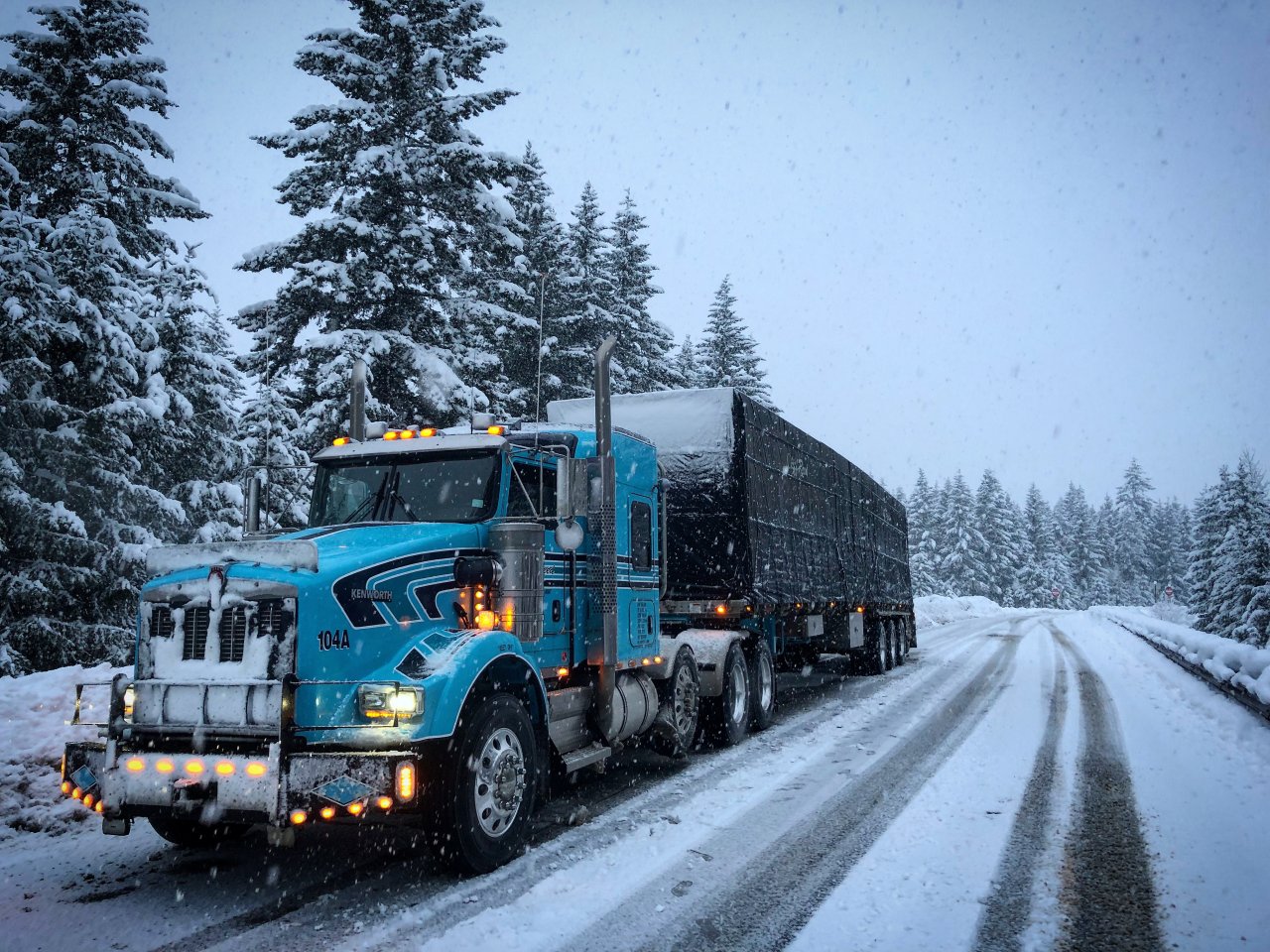

    Coolest truck ever
    Blackshack46 and Long FLD Thank this.

    1. You do a better job than that.
    2. You do a better job than that.
    peterbilt_2005 and Highway Sailor Thank this.
