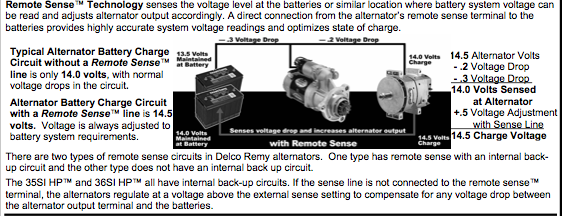

    I was looking at the brochure for the Delco 36SI that Hanadarko referenced. It shows a substantial gain in the mpg, being 70% efficient compared to the previous models 60%. A saving of $756 over 500k mi by their calculation. With a 3 Years / 350,000 Miles warranty. The BOSCH AL9960LH that Diesel Dave got, is also listed at 70% efficient in their brochure, claiming a possible saving of $400 per 100k miles. With a 24 month / 250,000 Miles warranty. The Delco shows using a remote sensing wire from the battery to adjust the output, to account for voltage drop in the cable and connections to the battery, whereas the Bosch doesn't. How, or if that affects the quality of the charge that the battery ultimately receives, is above what my two to three remaining brain cells can deal with.

    I did hook this line up. It remains unclear EXACTLY how this is supposed to help, but here is what I have concluded.
    Running an extra dedicated wire supposedly eliminates connection loss and resistance which can falsely lead the alternator to read a different voltage than it's supposed to.
    In their own example, they show a reading of 14.0v at the battery using the regular wiring vs a 14.5v reading
    at the dedicated remote sense line.
    Supposedly, that informs the alternator supposedly more accurately how to supposedly charge and
    change the voltage of the supposed charge.
    :biggrin_2556:
    Now, with that said, I measured the voltage at the back of the alternator via the stock cable
    and read 13.4v.
    I then measured the voltage at the dedicate wire and read 13.6v.
    Will .2v make a difference? - Supposedly.
    :biggrin_2556:
    If you had a wire, I'd hook it up. If not, I cant see much of a difference here if the wire is worth the hassle to run.
