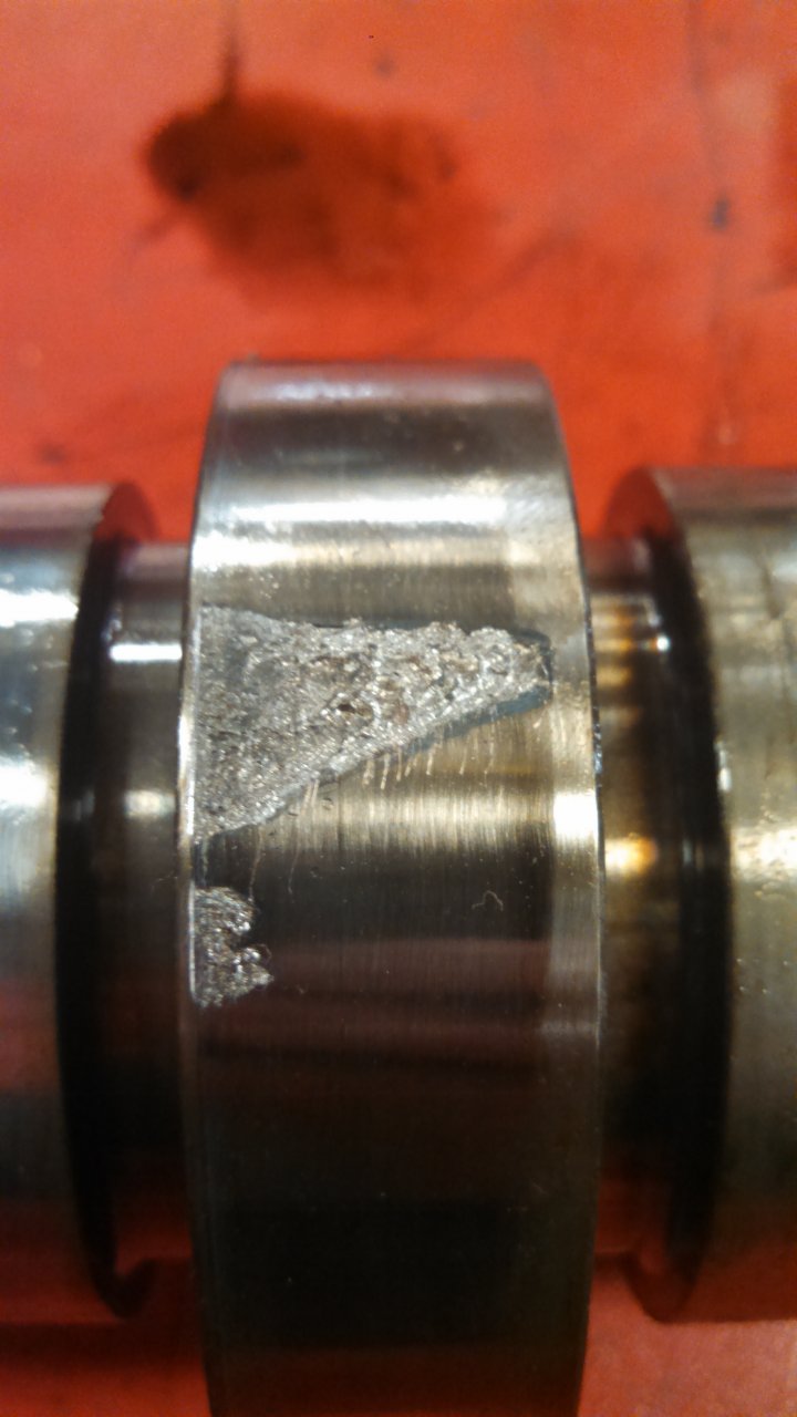

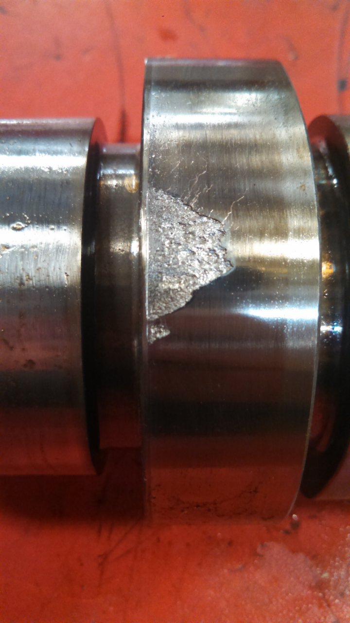

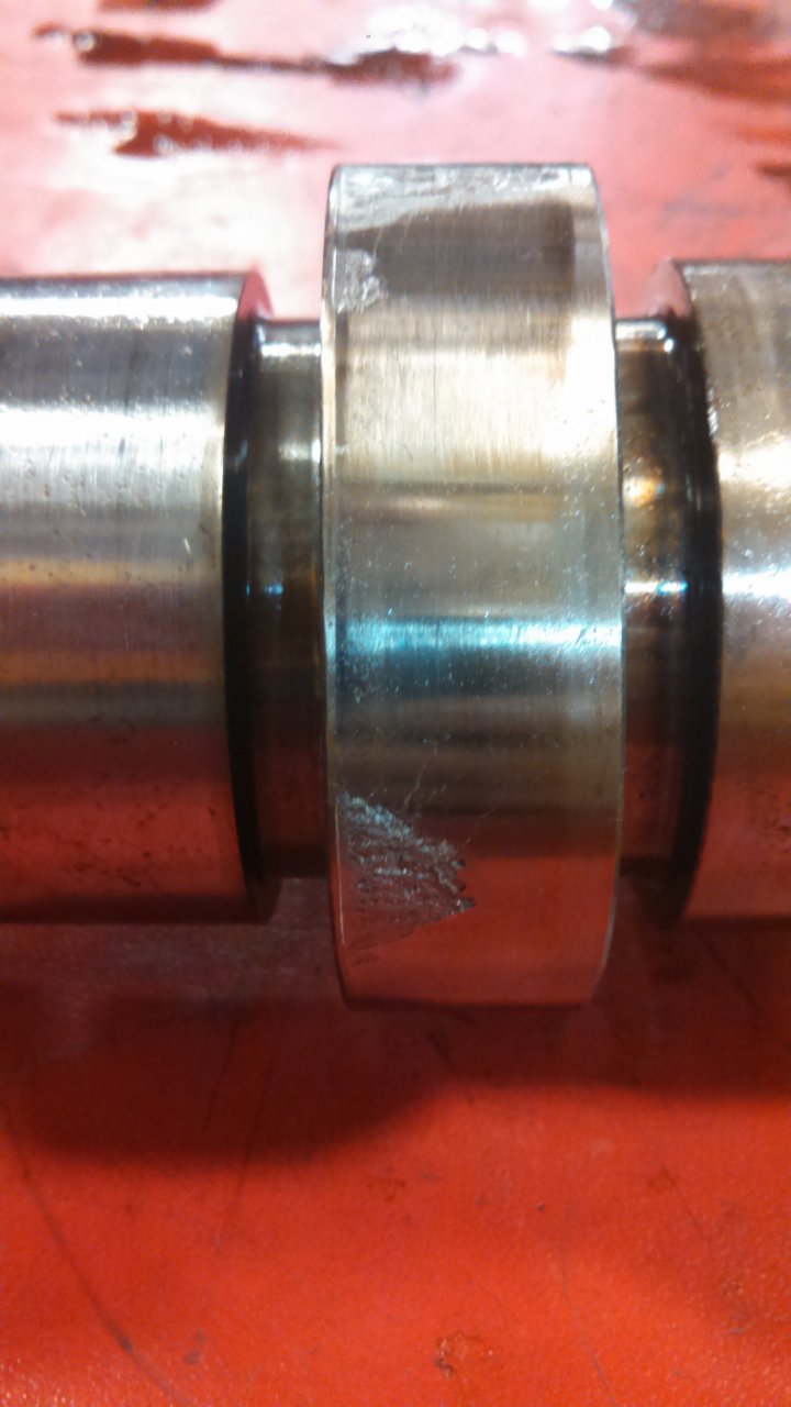

    So I'm not trying to beat a dead horse but just yesterday had a truck come into the shop. Been using amsoil 5w40 premium synthetic oil at 45 bucks a gallon and he just wanted a plain old valve adjustment done. Truck has 297,348 miles. And had a cam failure. I thought about this and decided to post a picture or two. He went by the amsoil rep recommendation and stretched his oil change interval to 60,000 miles and as a matter of fact was going to go get it changed after the adjustment. Also this is the first time the valve cover had been off since he bought the truck new. So all lash setting were from the factory. I spent a couple hours going over his service records which he actually keeps in the truck, and at least his maintenance records meticulous. The longest span between oil changes was 60017 miles. With his records I decided to get my DSM (Volvo corporate rep for our dealership) involved. The truck only had base warranty 2yr/250k on engine no purchased coverage. He was out by mileage. These are instances that most customers don't see where the dealership goes to corporate and tries to get them to goodwill either parts labor or both or a dollar amount towards the repair. Sometimes we succeed and the whole repair is covered, other times we get parts covered, sometimes they just decline any goodwill. This was one of those times where the rep had to decline due to extended oil drain intervals. As such Volvo states explicitly what oil change intervals are, and if records are kept and within acceptable limits the rep has the ability to goodwill up to 5 years 500k miles. I will say that he requested the can sent to a lab to see if it was lobe coating failure or due to the oil. We took a sample of the oil too. The failed lobe is #3 VEB lobe. Not an injector or valve lobe, a weird failure as I have never seen a single failure on one of those lobes ever. For full disclosure he came in with egr valve flow insufficient codes active (mass flow) root cause was egr cooler plugged with soot no internal coolant leak. I was able to get that repaired at no cost to the customer even though he signed an estimate for the complete repair. The rep did come thru in that instance. The customer was unaware of the goodwill until he came in and paid the bill. I explained to him the why goodwill was decline for the can and he was good with that and had been told previous about the drain intervals so he wasn't surprised by that either. As you can see all damage was to one lobe in 2 seperate spots. There was no damage to the roller but the complete rocker was replaced. IMG_20151208_173913_047.jpg IMG_20151208_173907_687.jpg IMG_20151208_173938_848.jpg

    it has to be something from the oil that is a very strange way for a cam to go bad i've never seen one like it specially on a veb lobe

    Is this cam from isx or d13?

    d13 from what it looks like

    D13. Its the exhaust brake lobe. I've seen a lot of can failures but never once seen a VEB lobe look like that, especially under 300k miles

    the cam journal doesnt look good either,full of small kraters
