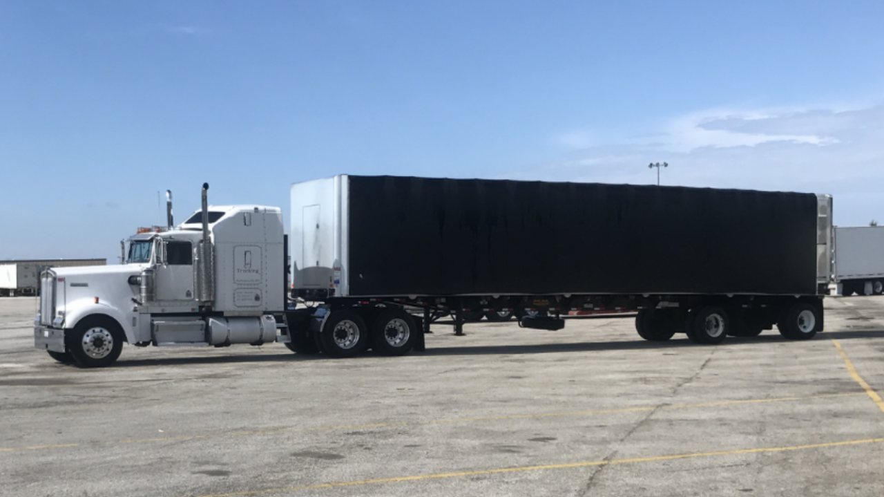

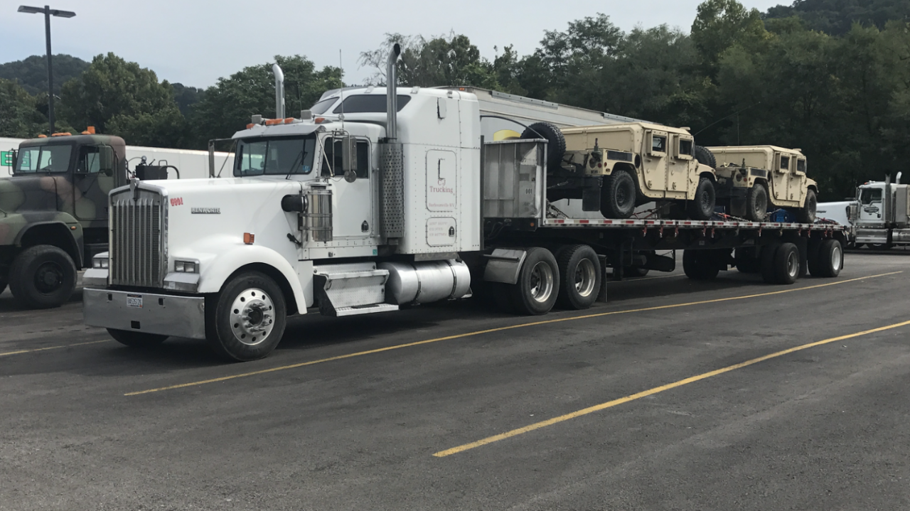

    Mine are stock 5”, I did the same thing. There is about a foot inside the mufflers. That was before buying the conestoga.
    Straight Stacks and shogun Thank this.
