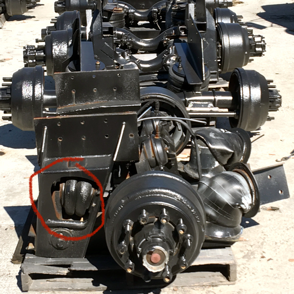

    Red circle is the lift axle air bags.
    Spray these with soapy water.

    Ive sprayed those with water, those aren’t leaking and look fairly new as well.
