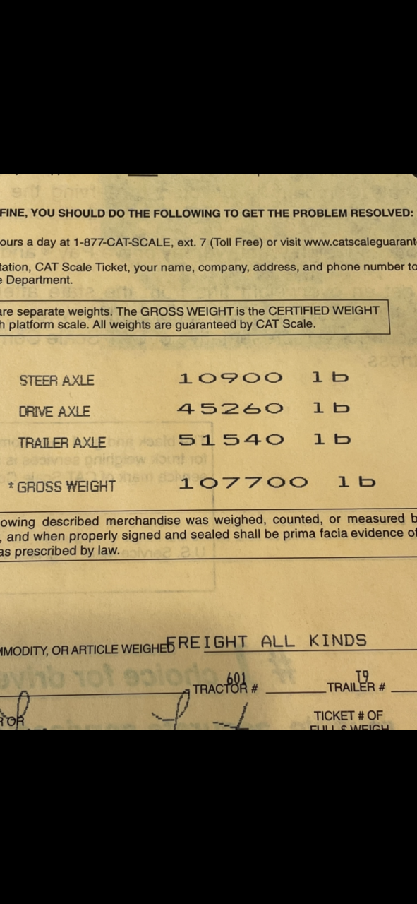

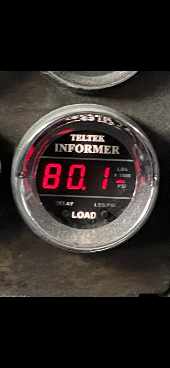

  7. OLDSKOOLERnWV
    Joined:
    Messages:
    18,866
    Thanks Received:
    284,376
    Location:
    That’s how mine is set up….
    AC53EE4B-9E9F-4353-B4D2-DD378A5BD06C.png 11FDD530-BC1A-406D-8D08-0465BE0973B7.png

  8. Big Road Skateboard
    Joined:
    May 2, 2021
    Messages:
    6,646
    Thanks Received:
    37,314
    And you don't have to figure out "was this 32 or 33k in the mid 60's"? 20230522_103001.jpg
