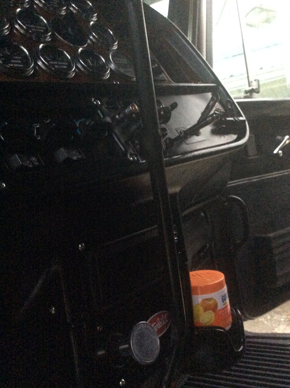

  3. Collie
    Collie Guest
    CB5DFD74-DEE2-45E5-BC51-CF108EC1301B.jpeg Just went out and flipped the shift tower around the opposite way for the hell of it. Didn’t change much, maybe an inch.
    Here is a pic of the shifter in neutral. Rests on dash
  4. Collie
    Collie Guest
    Will that shift bar housing come through the shifter plate hole?
    Or is this just too much a pain in the ### and should I just drop the trans.
    What would you do
