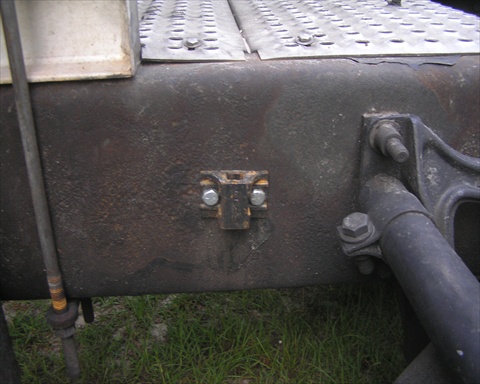

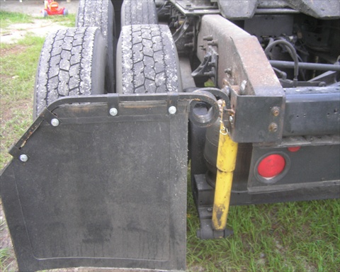

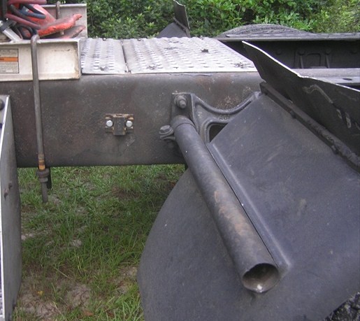

    While dragging around a homemade lowboy I tore off 3 mud-flap.. Tore one slid the fifth wheel and fixed it then tore both sides off a couple of days later..... Vowing never to have to do this again I decided to go this route... Bought the 45 spring-loads for about $50 plus an extra set of hanger brackets. $12.... Installed them on the rear as normally would but put the extra set up in front of my quarter fenders... Pull the hair-pin clip and Just move them to the "SAFE" area when ever needed... No more busted flaps..:biggrin_255:
