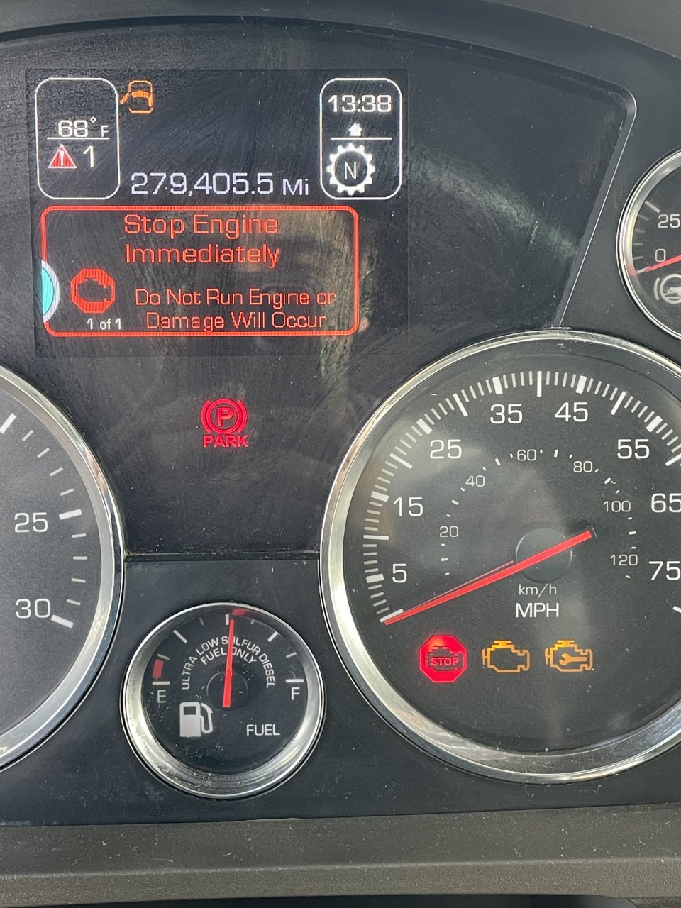

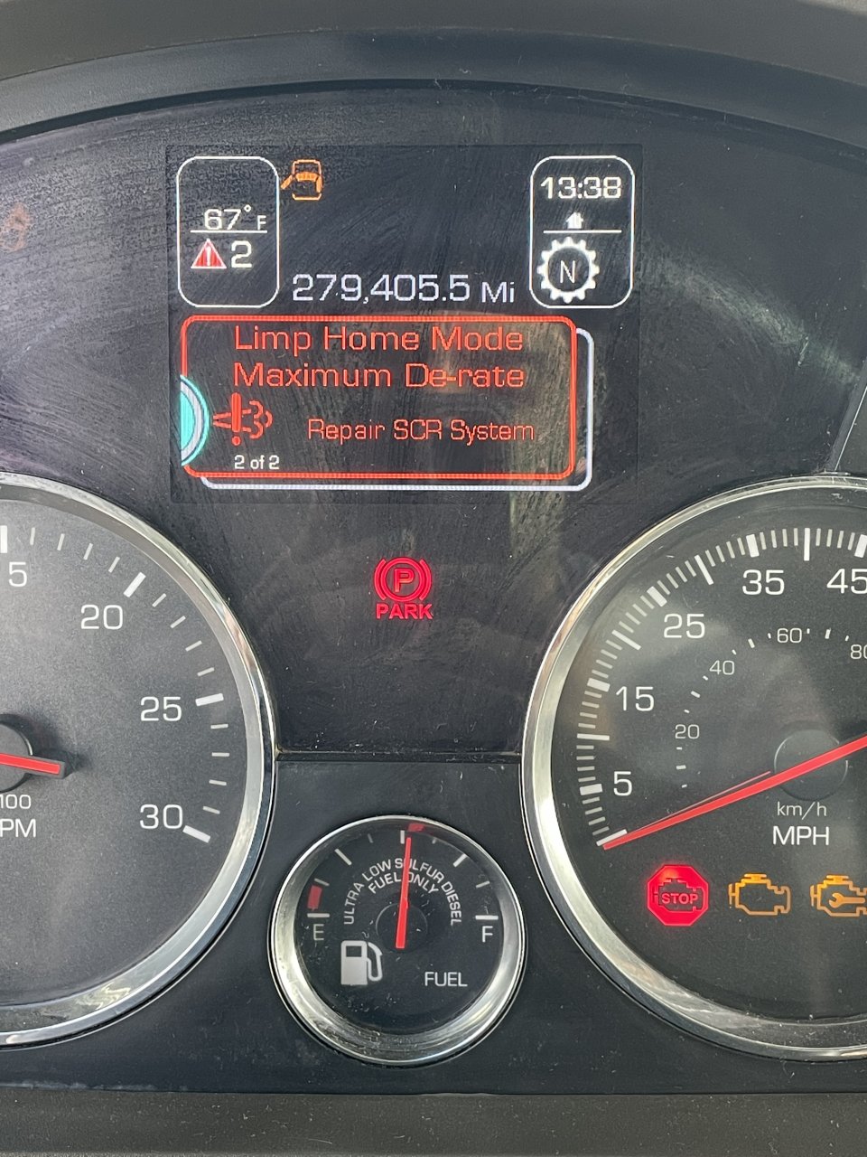

  8. Kairen0001
    Kairen0001 Light Load Member
    Joined:
    Dec 17, 2021
    Messages:
    109
    Thanks Received:
    120
    39E415AF-259D-4ADE-98CD-858D34D27B25.jpeg 9C3B91D9-9E44-4DFE-BD12-EC6ADE458CE6.jpeg 39E415AF-259D-4ADE-98CD-858D34D27B25.jpeg 39E415AF-259D-4ADE-98CD-858D34D27B25.jpeg UPDATE
    Today I decided to check everything out again by myself. Took a flashlight and inspected all the connections under hood and under truck. Checked everything I could reach. All looks good. So I started the truck. First 3-4 min nothing was wrong. Then I noticed that DEF gauge came to 0, and red light flashing, but no warning lights on a dash. In couple minutes CEL came on, and after stop/start key cycle dash showed: stop engine immediately! You gonna be kidding me?!?!? Really? REALLY????
    But now it doesn’t shut off by itself and no transmission malfunction light…. Omg, what a crap those modern cars and trucks…

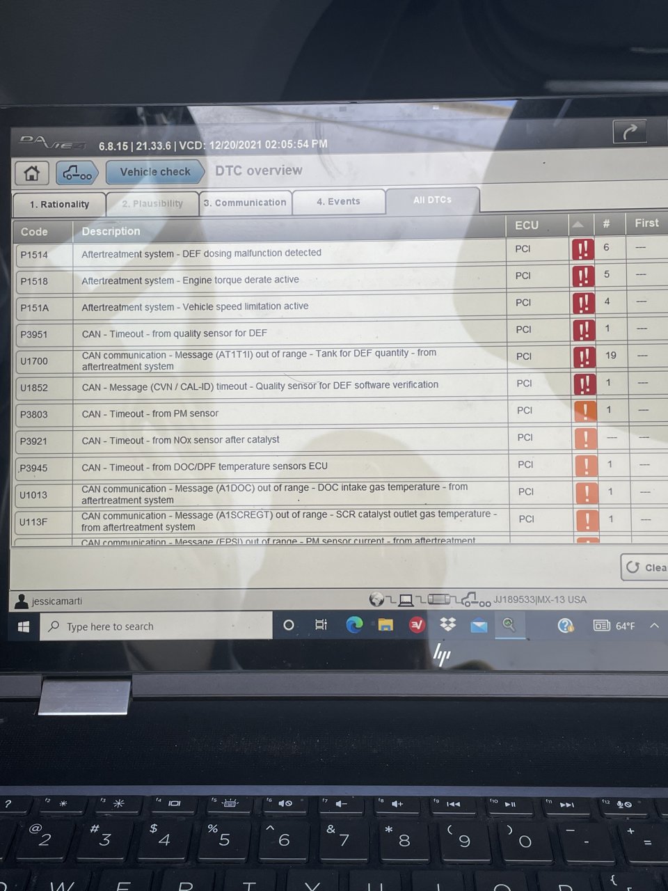

  9. Kairen0001
    Joined:
    Dec 17, 2021
    Messages:
    109
    Thanks Received:
    120
    Another update:
    Codes picture. I was told that this is another issue not related with previous one. And def level sensor needs to be replaced.
    Goodysnap Thanks this.
