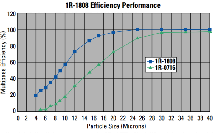

    FWIW, I have an OPS with its 4-micron filter (came with the truck), but I'm very interested in Dice's extended oil change intervals w/o bypass (better?). So far his samples look every bit as clean as mine so if he can accomplish the desired result (safely extending drain intervals) with less cost & complexity then that's something to be proud of. It certainly isn't the mark of a Rutherford lemming.
    That's certainly the sales pitch. But Dice's results led me to do further research and I discovered that a 4 micron filter does not remove every particle 4 microns in size. It probably removes only half of them (50% efficiency is the minimum required to have the nominal designation). A standard CAT 1r-0716 filter, on the other hand, manages to filter 2% of 4-micron particles it sees.
    Now if the 4 micron filter sees 6 gallons per hour and filters 50% of 4 micron particles and the 15 micron CAT filter sees 100 gallons per hour and filters 2% of 4 micron particles -- what percentage of 4 micron particles have been filtered after 1 hour (assuming a 10 gallon capacity)?
    (6/10 * 50/100) = 0.3 or 30% for the bypass
    (100/10 * 2/100) = 0.2 or 20% for the OEM Caterpillar filter.
    Golly gee, lets all run out and pay $650 for a new OPS-1 and $40 extra every filter change -- all so we can filter 10% more particles per hour that are too small to do any real damage anyway.
    Edit: actually it isn't quite that simple because you add a bypass system on top of full flow, so you'd really be comparing 20% oem 4-micron filtration against 50% oem+bypass (20% + 30%). Still, the difference isn't nearly as drastic as it sounds on the radio or at the MATS booth -- at some point your filtration is "good enough" and additional gains are just a waste of money...
