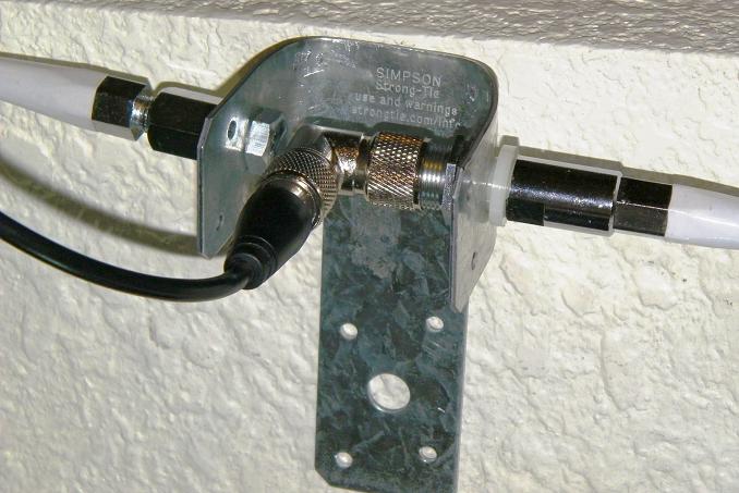

    positive and negative element tune the same way...
    http://www.thetruckersreport.com/tr...-antenna-solution-for-fiberglass-cabs.135122/
    easy to make bracket from scratch.
