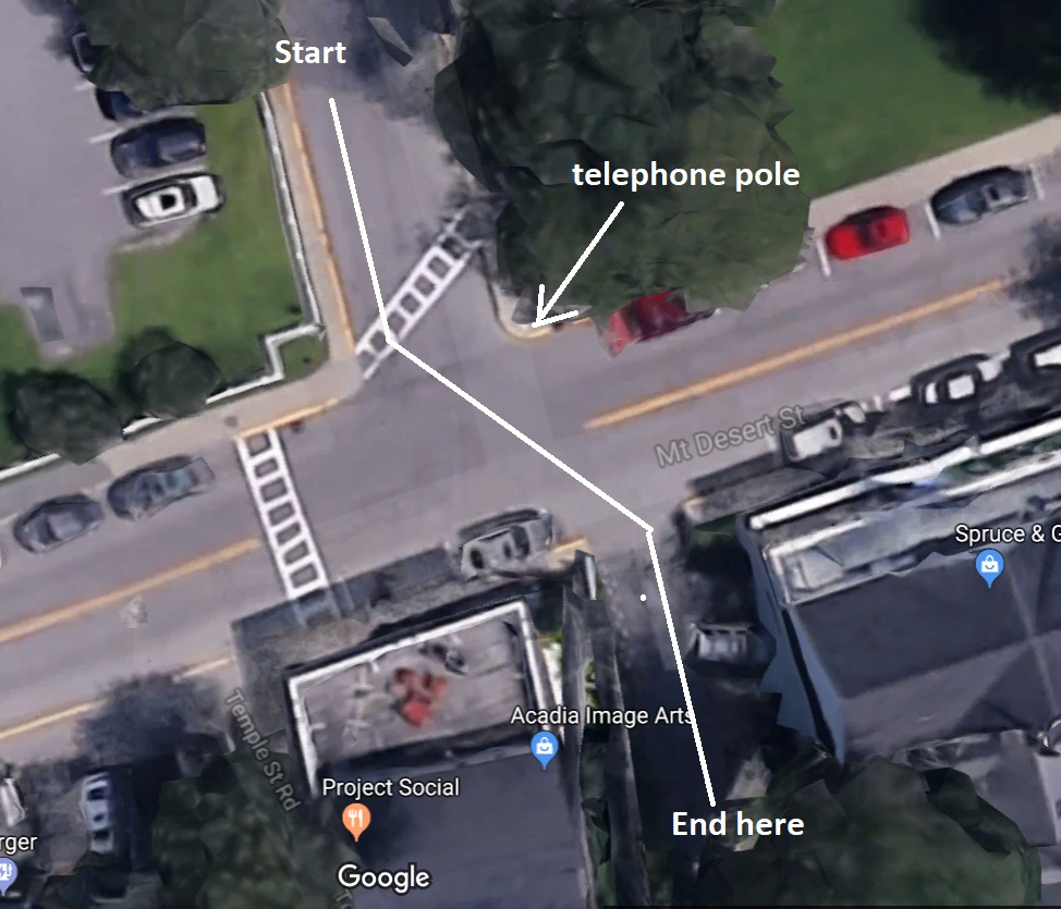

    Picture this.
    Bar Harbor Maine

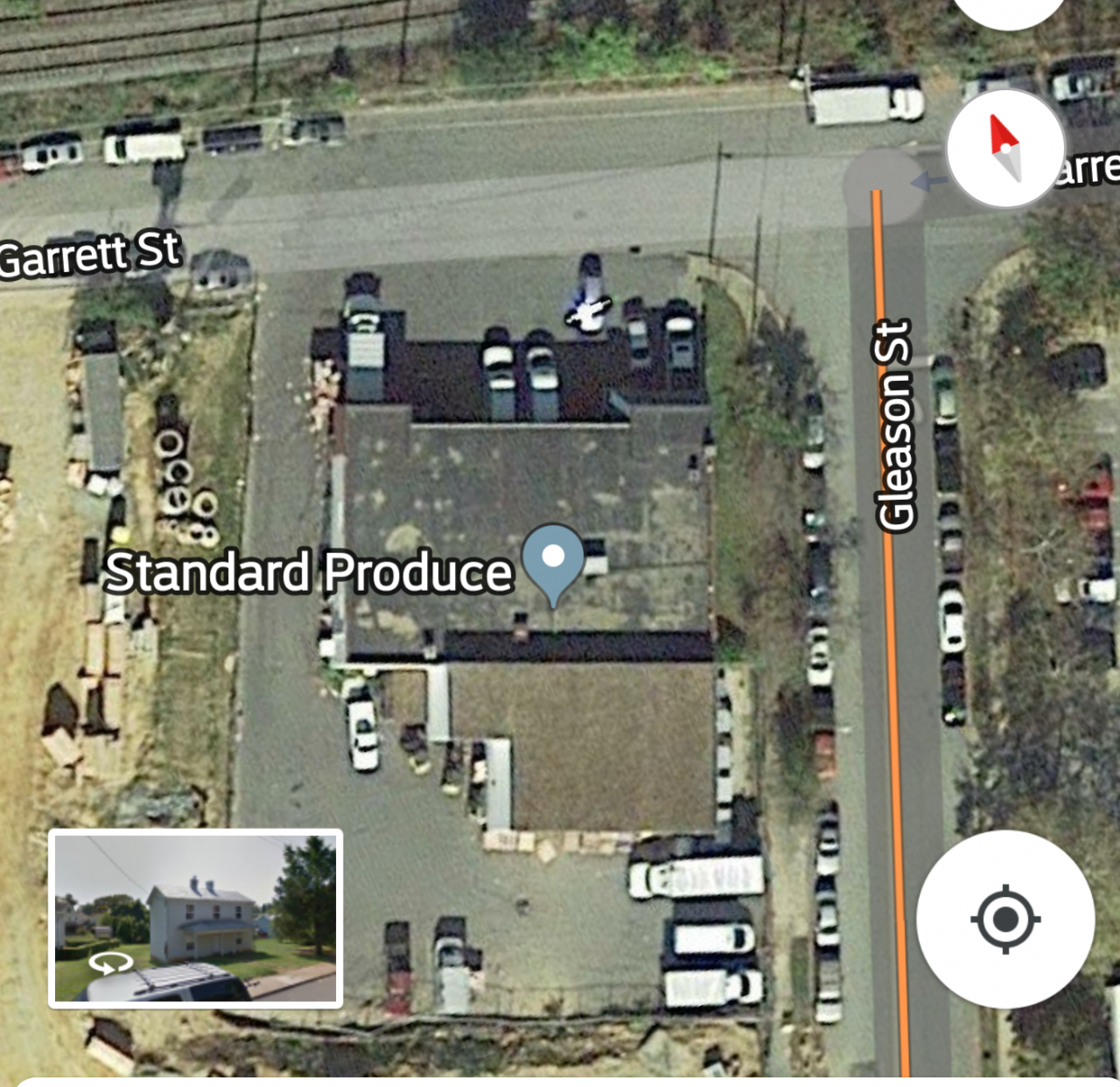

    Garrett St. dead ends just off edge of pic to left. Must get onto dock at produce store with tractor and trailer jack-knifed at 90 degrees so as not to block Garrett St. If one looks close the shadows of 2 telephone poles can be see opposite Garrett St from produce store... They have both been hit and scraped many times. Once unloaded must pull up to dead end of Garrett St, then back up past Gleason St. so as to take Gleason St. out.
    Truckermania and lovesthedrive Thank this.

    Cattleman84, if Garrett is a dead end just out of the picture, what is so important over there that you can't just block the street?
    Or if you're gonna be there awhile, just drop the trailer...

    It almost looks like you can set your rig up straight on the "start" street so you can see your target on the "end here" street
    then pretty much back straight in...
    am I missing something here?
    I suppose you might have to make minor adjustments to miss that pole or a car parked on the opposite corner...
