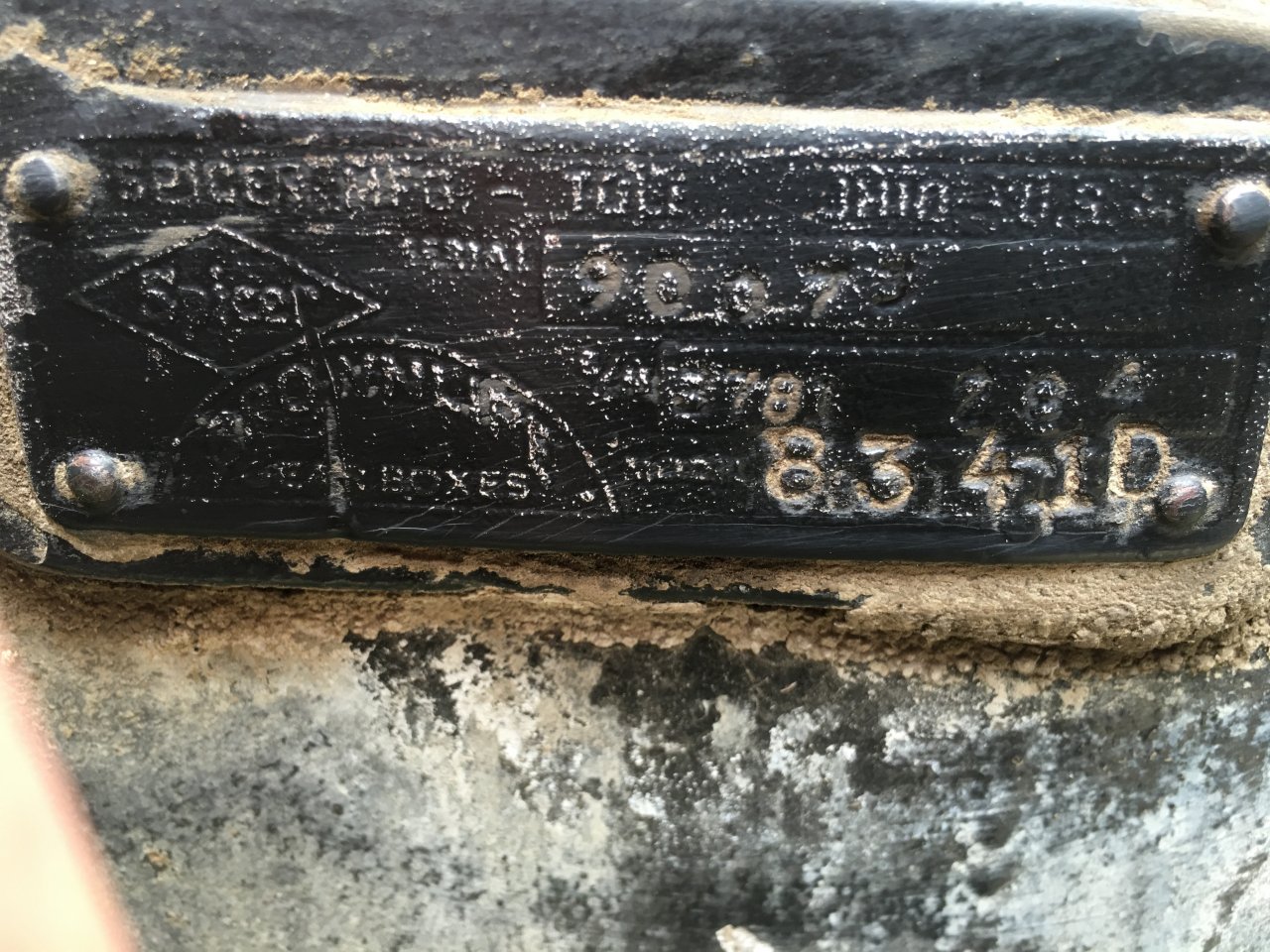

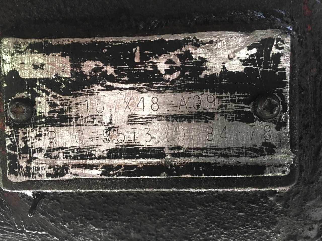

    Posted from under the truck
    truckdad Thanks this.
  5. truckdad
    truckdad Road Train Member
    Joined:
    Dec 14, 2014
    Messages:
    2,033
    Thanks Received:
    16,751
    Location:
    Penn Valley, CA
    BigZ, I cant remember if the 8341D or the C had the "deep under low" but @ColoradoGreen will probably know but one way to tell is: Put the main box in low, engine idling, release the brakes, and WITHOUT the clutch, very very gently push the aux box lever towards the low or 1st gear position. You should start feeling the gear teeth touching so slow that you can time them, then you can actually shove the thing into gear without even using the clutch! Thats how low this gear will be. DISCLAIMER!!! Back in the day when I was driving the 72, coming out of a ranch with multiple gates to open & close, I would open the gate, put er in low with a little drag on the trailer brake & let it go while I closed the gate then walked to catch up with the truck. I'm sure I'm not the only one that ever did this...................
