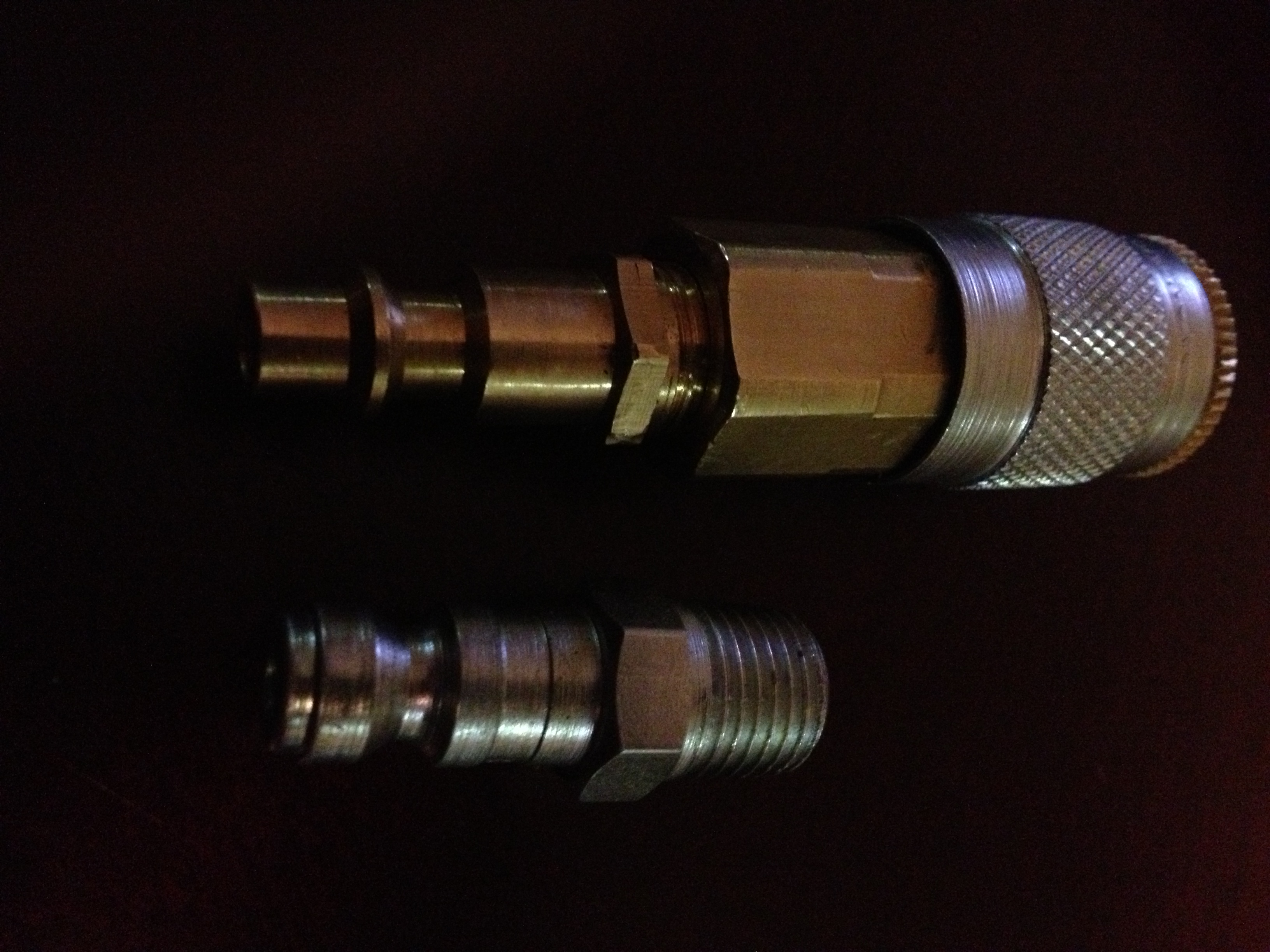

    Not sure about California... I just plain didn't go there. But a follow-up to my last post.. I misspoke when I said you could fit a 1/2" connector to your wet tank... it's a 1/4" you can fit onto one.
    These are what I was referring to. The top one is an industrial type connector, fitted to the female end of an automotive type hose connector. I help the guy I ran OTR with maintenance sometimes, and I use that as an adapter so I can use my air tools with his compressor without having to change out the fittings in my air tools.
    The bottom is an automotive type connector.
    Depending on how the port on your wet tank is set up, the way to do it would probably be to get a 1/4" hose connector threaded on both sides, and attach a female end to it. If you have a valve to cut off flow out of your wet tank through that port, I'd recommend you put on a male end, and get a hose with two female ends.. you'd probably want about a 70 ft. length of air hose, and attach the ends yourself, rather than buying one already made. You can run an air chuck, pneumatic grease gun, and some air tools with this setup.

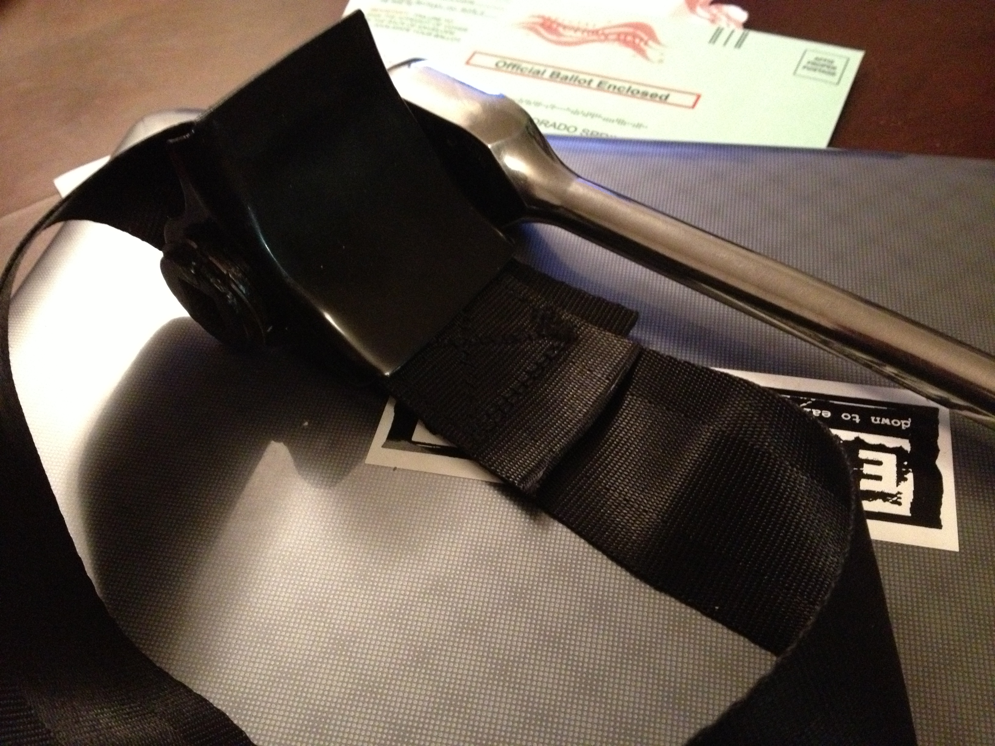

    Here's the filter wrench I was talking about from Caterpillar. It costs about $16, and is adjustable for all different filter sizes. You can use it for fuel filters, lube filters, coolant filters, hydraulic filters, etc. I misspoke earlier.. I just hook a 1/2 inch drive ratchet directly to this one.. the one where I'd take a 3/8 inch drive ratchet and space it with a 3/8 to 1/2 inch drive ratchet was a different filter wrench from Mac Tools. If you want to pick one up from Cat, the part number is 185-3630. Which ratchet I use depends on my whim... I usually use my 1/2" drive swivel head ratchet, but you can whatever.. straight handle, flex head, swivel head, breaker bar... it's yours to choose.
