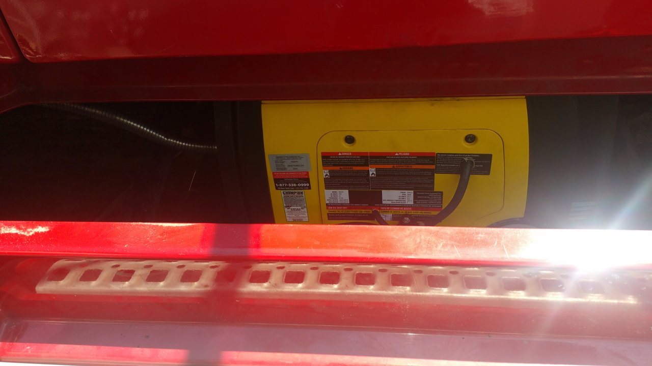

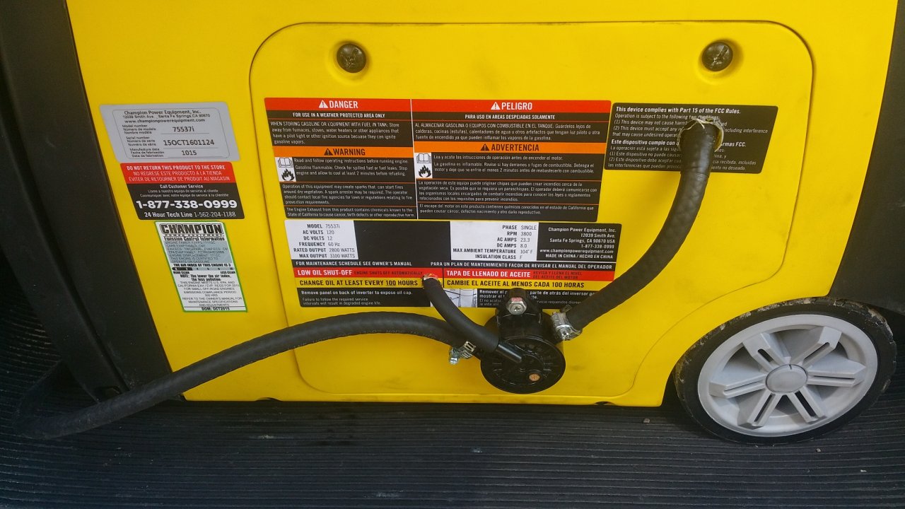

    Here are some pics of my setup.
    My volvo 780 had a spot on passenger side perfect for the generator. I added a cable lock to it and strapped it in. I ran the exhaust out the back and installed a fuel pump (see pics)
    I added an 8 ft exhaust pipe like the above one pictured to pipe the exhaust away from the cab.
    Installed a c02 monitor and it stayed at 0 ppm for so long I took it outside to make sure it was working and sure enough, it recorded the co2 and setoff the alarm.
    It will run approx 70 hours on the tank and will run the a/c in econ idle mode.
    Very pleased with this setup. 20160615_150400.jpg 20160615_150426.jpg 20160615_150447.jpg 20160615_150533.jpg 20160615_150550.jpg 20160615_150632.jpg
