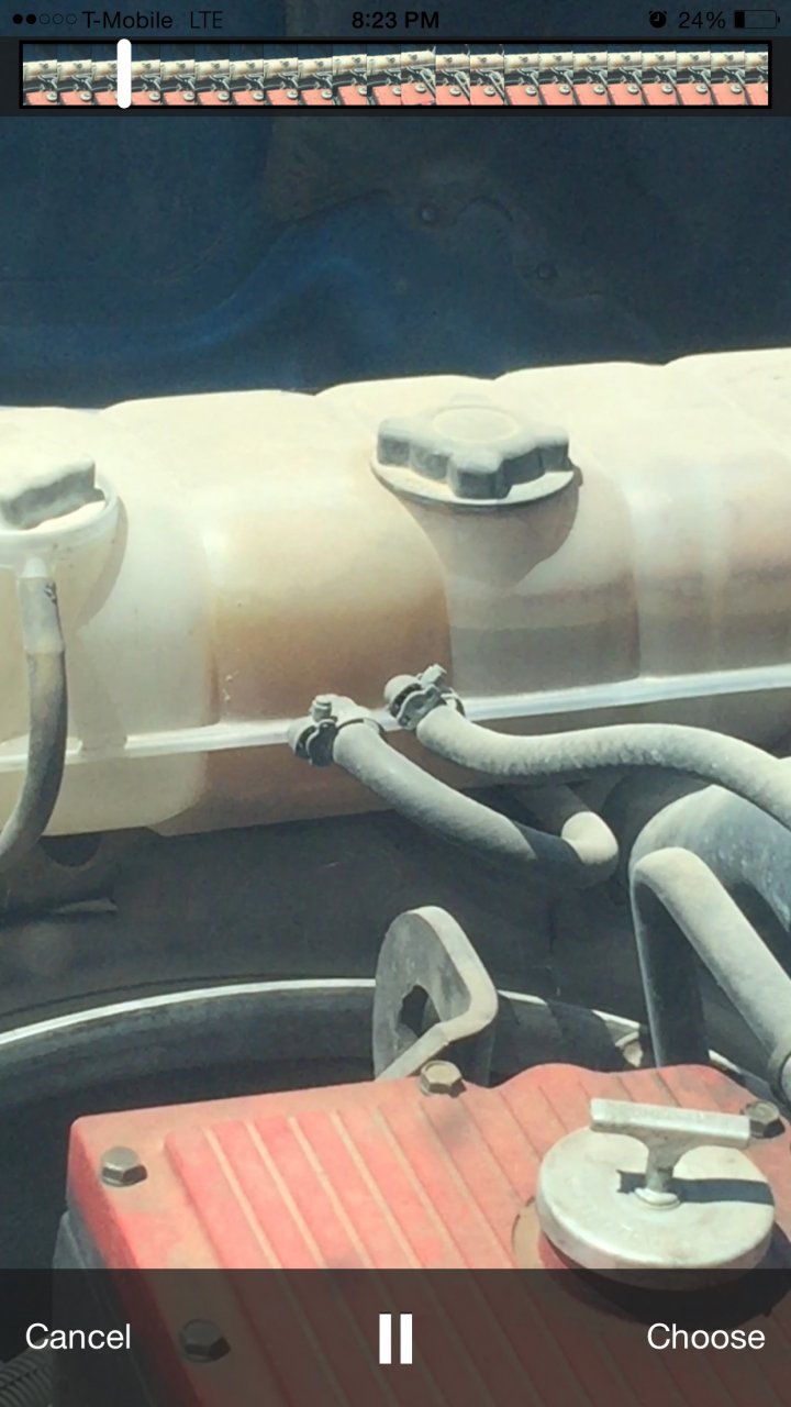

  11. Youngtrucker91
    Youngtrucker91 Light Load Member
    152
    49
    Aug 11, 2015
    Hi I'm about to buy a volvo truck with a n14 Cummings select plus but can any body give me and idea why it does. The water inside the antifreeze tank moves? It doesn't leak it just moves around
