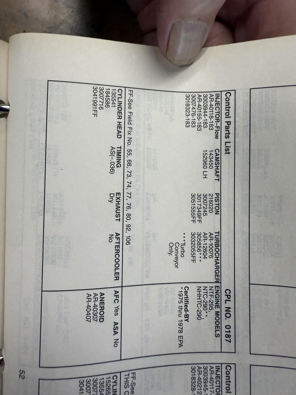

    Here’s the CPL number you mentioned, hopefully be some info to help you….
    campwells Thanks this.

    This is exactly what I found. These parts are definitely in this engine. Also got my hands on an old Cummins D.I.M dial card, not that I need it but i got it.

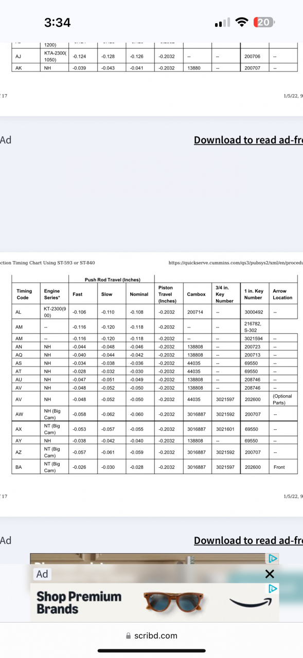

    IMG_0506.png The AS initial timing lines up with what is in our manual. Both that CPL and this timing index show it to be a 1975 at earliest, its in a 1973 so I’m assuming the army just had a stockpile of these rebuilt to their specifications and this old truck was gifted with a rebuilt motor at one point.
