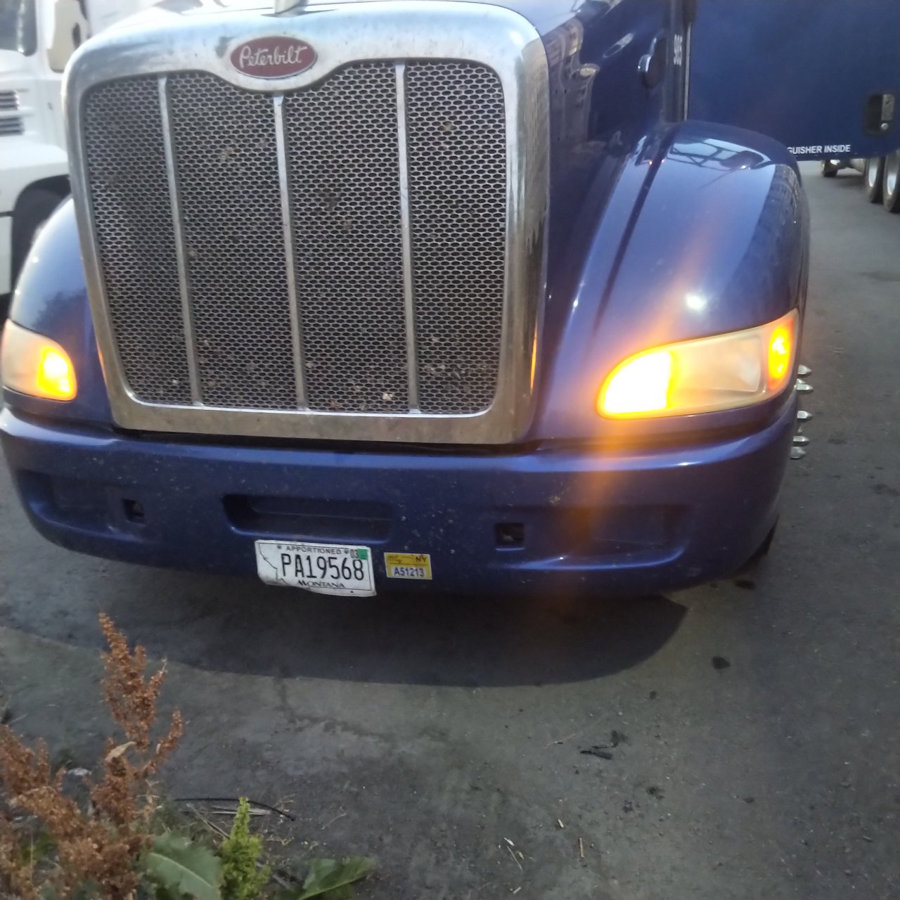

    Yep thats exactly what i did. It was corroded all the way to the pin . First time i ever depinned and repinned a harness but it went smooth as butter... we have light !! Thanks for all ur guys help..
    I think im gonna have to carry a small kit of plugs and pins with me to build a harness , because this truck has alot of hack wiring jobs from the previous owner ..
