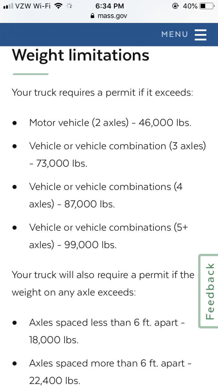

    Out of service in Massachusetts..... gross weight over his permit ....
    They parked him and said get a super load permit.
    P.S. that’s what you get for running 8 axles around here .....:)

    “They give you much less weight in Massachusetts”
    Don’t they give annuals for 120k on 5 in mass? I’m pretty sure that’s the number.
    This is for state of Mass, these weights are just registration weights, not even overweight permit weights-
