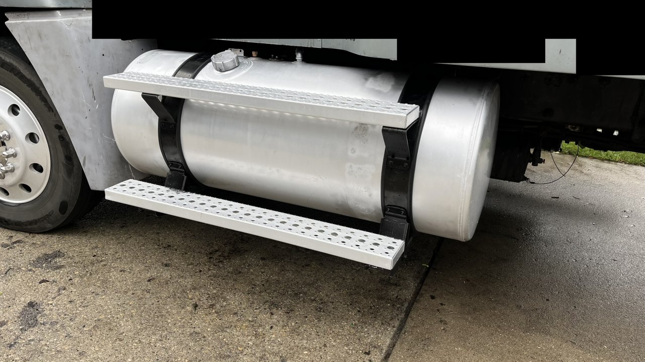

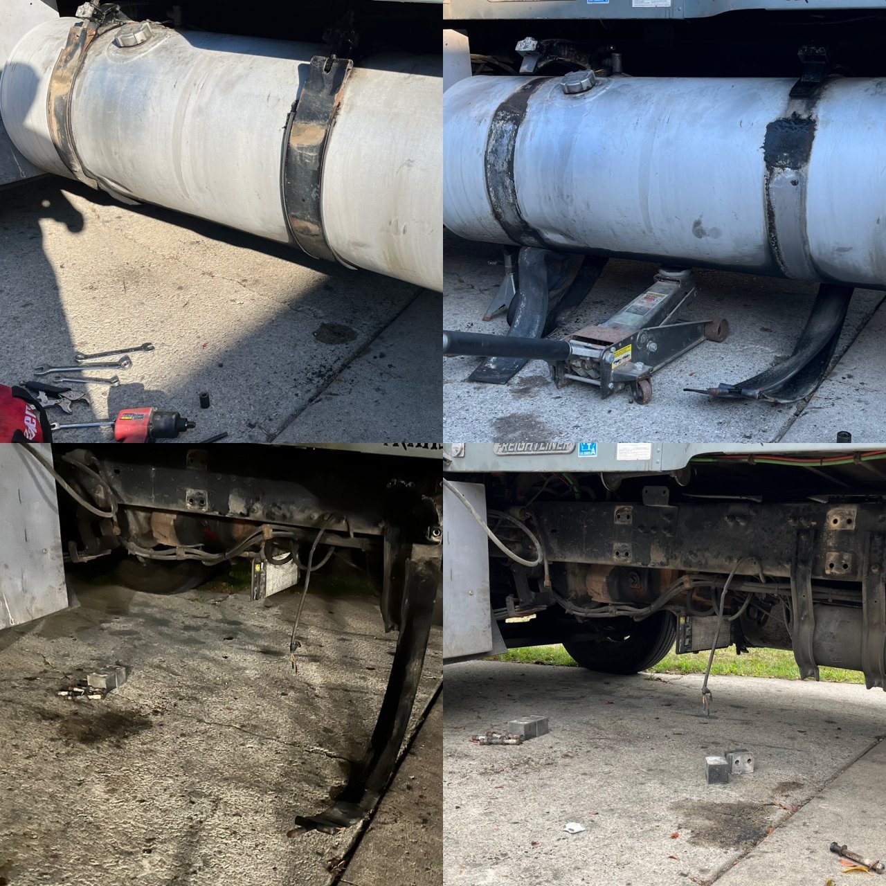

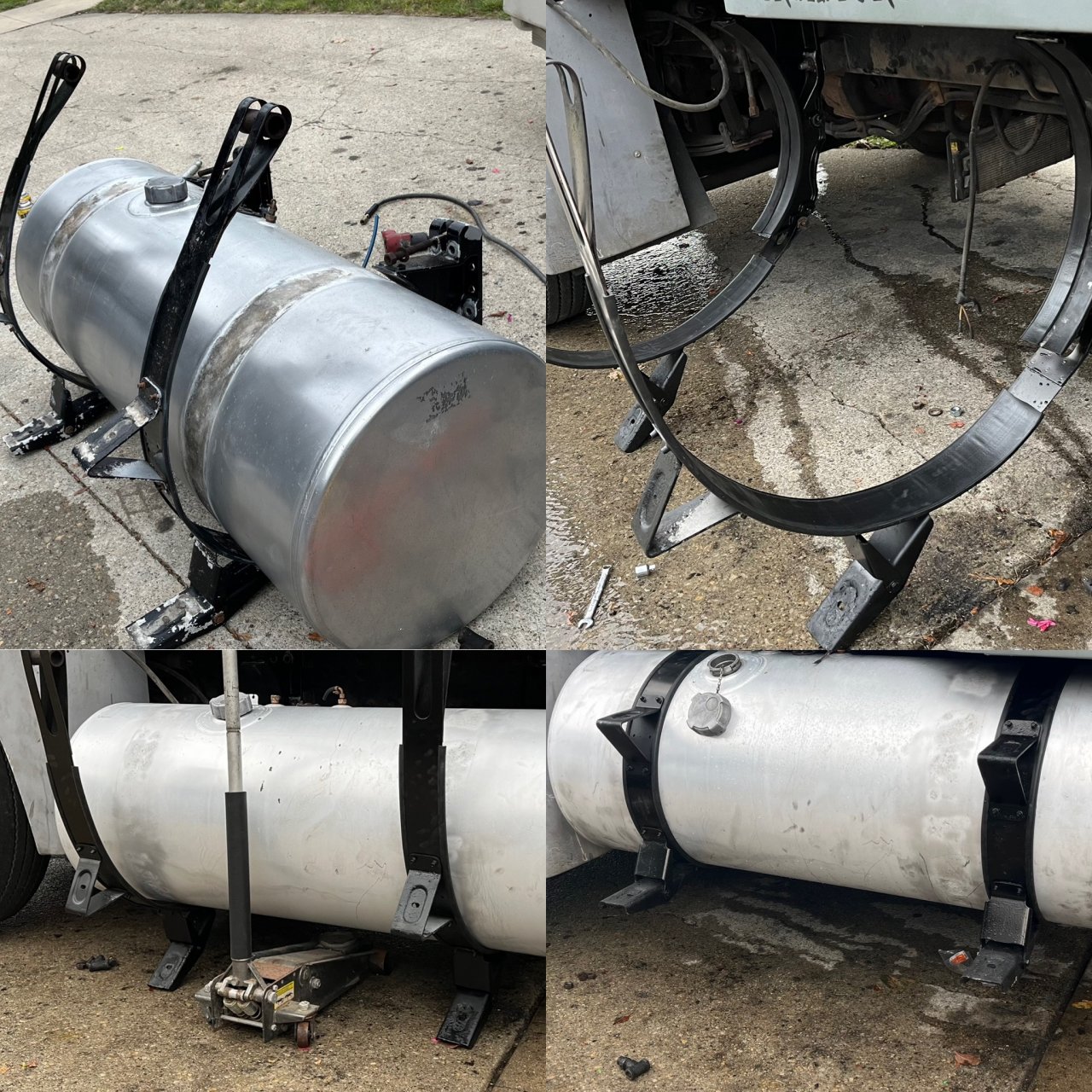

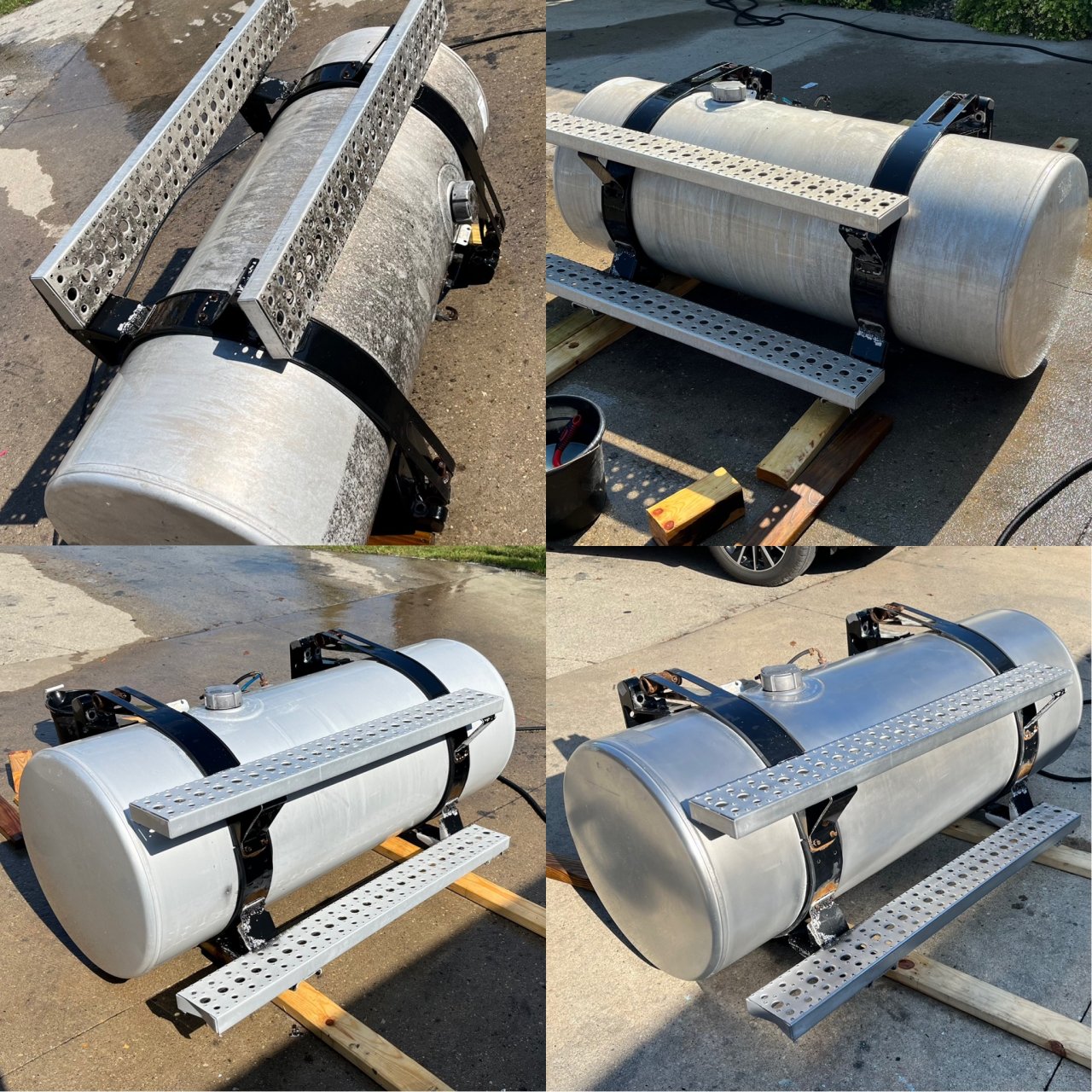

    - Replaced my driver side fuel tank with a used 2005 Cascadia tank, bracket and steps. This was a huge process, but I was able to get it done in the driveway! I will make a separate post about that.

    Well here’s a few pics and follow up on the tank swap. I had been dealing with leaks around the welds for months so I’ve had to run with half full tanks every day so it wouldn’t leak. I sanded and epoxied it probably 10 times and got tired of it. I can’t weld aluminum and wouldn’t trust myself anyways doing it on a diesel tank. Got a used one for $650 and tackled it myself. It would have been probably $1000+ for 8 hours of labor to remove it and weld it at a shop.
    It probably took me 15-20 hours over the course of 4 days - lol. But I’m happy I did it and learned a ton and it was a good confidence booster for sure. A little help from the wife to move the new tank into place but otherwise a mostly solo job.
    Here’s some pics. I’m happy with the result!

    Nice job!
