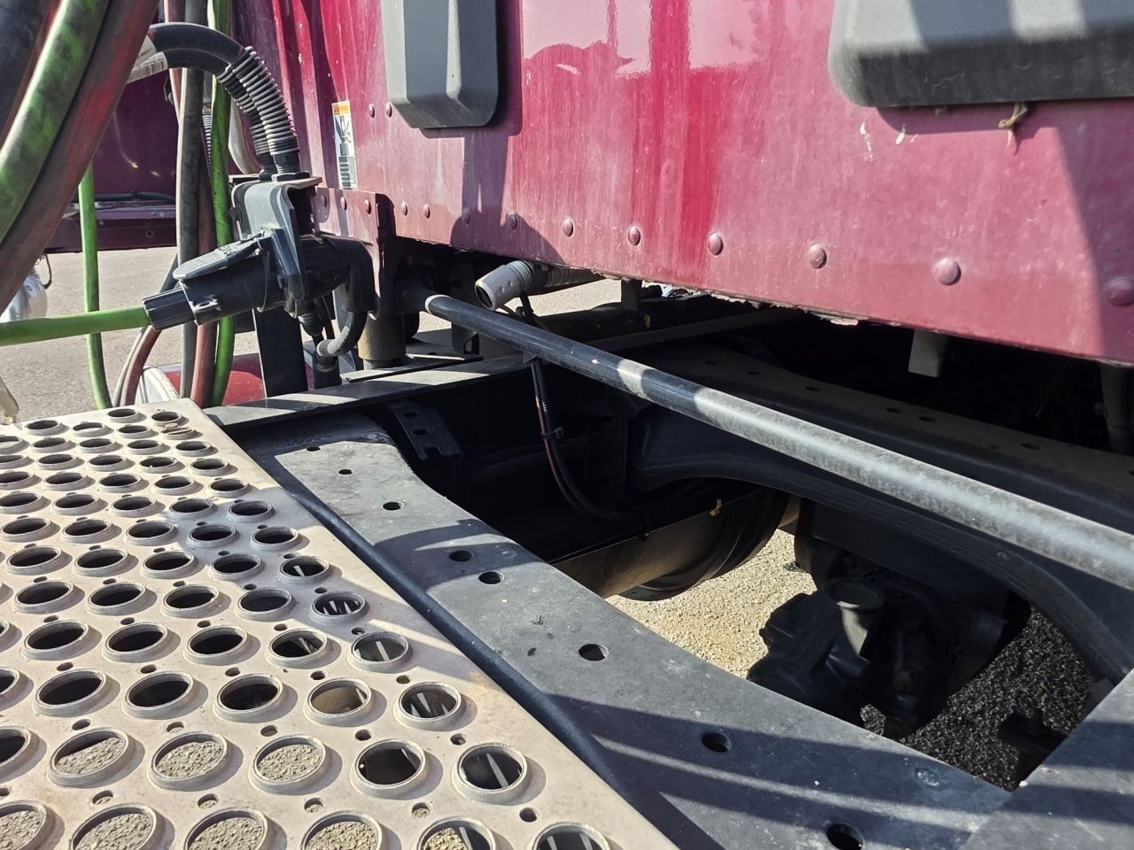

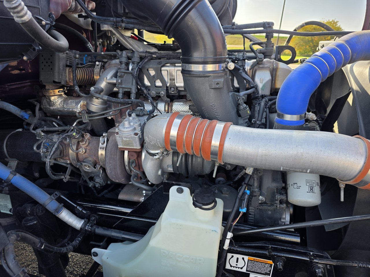

    Those cab shocks always rust. They're like $100 apiece. I think you got a pretty good truck to start out with and a lot of the MX13 hate is a little bit the typical "Ford vs Chevy" stuff where somebody has a bad experience (or a great one) with one or the other and thinks they're all that way. Hang around the internet long enough and you'll have 12 different opinions from 10 different people. All you can do is treat it as right as you can as far as regular PMs, no cheap parts, stay away from shops you don't get a solid impression from, and don't idle it unless its an extreme weather situation.

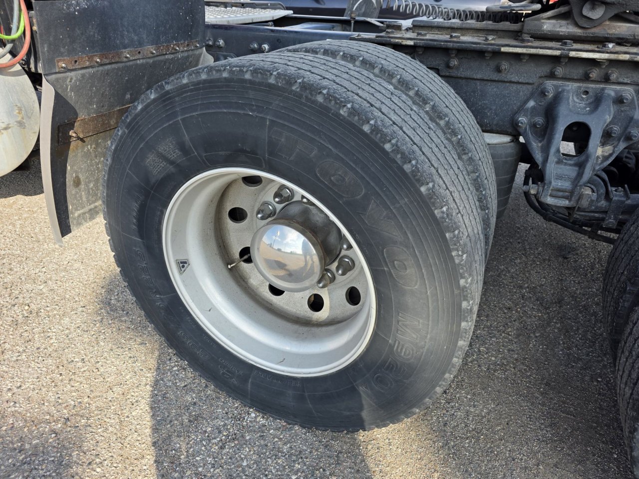

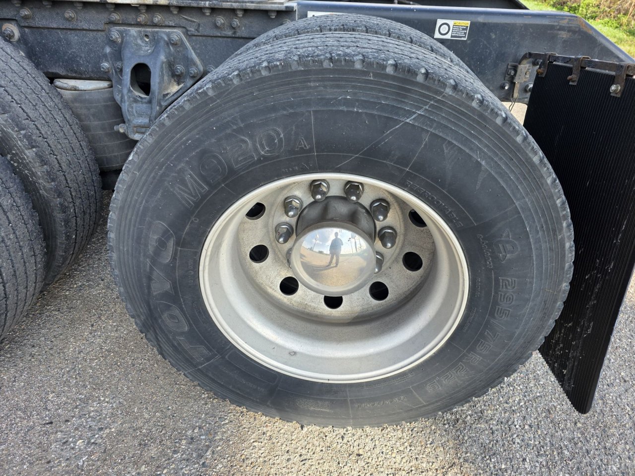

    I wouldn’t swap tires. My ‘22 had the 12 spd with 2.79 rears and it was perfect for running 68-ish. Around 1300 RPM right where it needs to be. At the speed you said you want to run going to larger tires would have the trans shifting between 11 and 12 all the time.

    I am realizing that the Paccar MX13 has issues when hauling heavier loads over 38k lbs on steep hill type terrain. I've been refusing heavier loads in order of not being in the shop with a check engine light even after a recent DPF cleaned and all new injectors back in May. Issue after issue besides the freight market which seems to be improving but always comes down to the Paccar without issues now not covered by warranty. This video speaks volumes and when meeting others in the garages whiles their waiting for their trucks 8 out of 10 at Peterbilt dealerships have the same engine in their truck at any given Pererbilt dealership in any state or province. Coincidences can't occur that much in one year and their hasn't been a month yet I didn't have to go into the garage for something. Maybe for some they believe it only has minor issues oppose to major but I've personally never seen a motor in my 30 plus years of driving seen this much problems. When purchasing back in 2022 I should of gone with my instincts of not knowing much about the Paccar engine. My recommendations for anyone who's stuck with one is not to idle the motor at all if they can help it and be sure to change the oil regularly before 12,500 miles even though online it says 40,000 mile oil change intervals. I am starting to believe with the biodiesel is a major issue for the paccar motors and I've been trying to avoid it when ever possible but it's been difficult regarding most major fuel suppliers supplying biodiesel.

    Nah, that would make the overall gearing worse. I hate the 2.79 rear ends in mine. Makes overdrive too laggy/luggy. 65 MPH it’s lugging along at 1250 rpm. Have to get it up to 70 to get up to a more comfy and smooth running 1350 but 70 is a little fast unless you’re really out in the wide open stuff.
    I’d rather it was running 1350 at 65 personally and I would spend a lot less time babysitting the autoshifting transmission. Most of these trucks of course are tuned for MPG and not performance so it always wants to be in the highest gear possible not matter how inappropriate it might be for the driving situation. (I almost miss the good ole days where the transmission stayed in whatever gear you shoved the stick into lol.)
