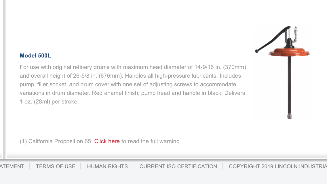

    I’ve got two of these type in my shop, one for 75w-90 the other for 50w. Cast housings, solid build, smooth operation (with oil anyway).
    I’m still digging for the exact part number on The Lincoln website so you can google pricing. The model in the pic is for Refilling grease guns and only pumps 1oz per stroke. I’ll have to get a model off the one in the shop. The ones I have move more fluid.

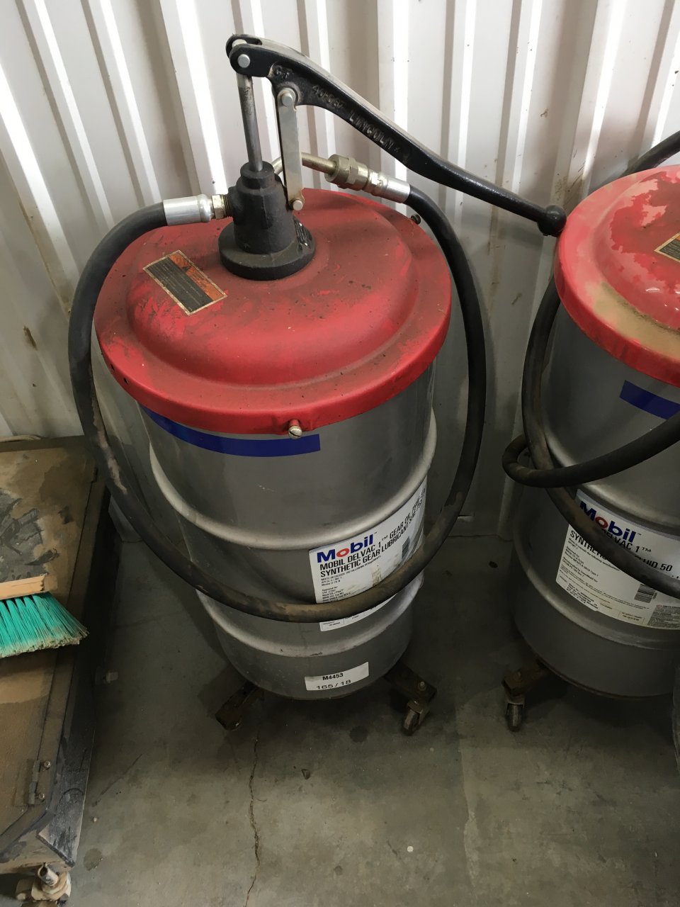

    8E43490E-ECBB-43E1-A6E9-5E9FD6D071B8.jpeg EFC59466-943D-4E0D-8CC4-BC0877145389.jpeg

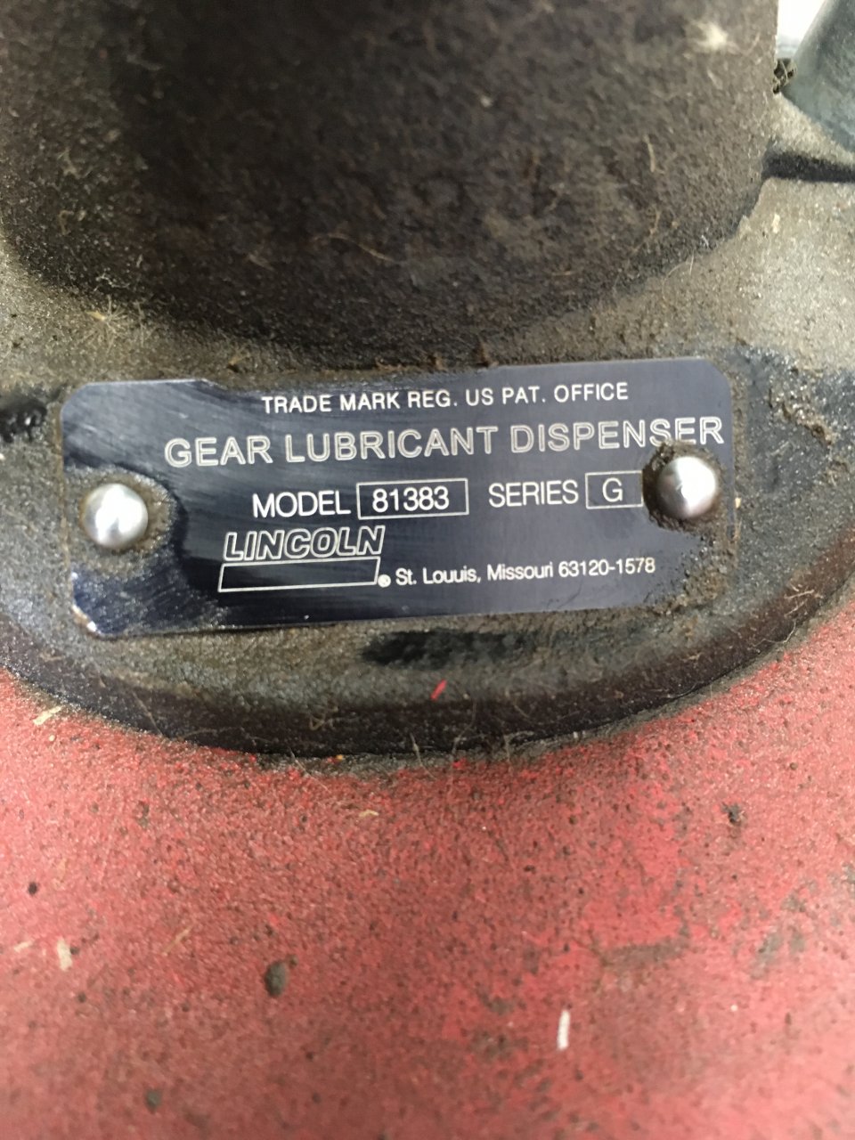

    Remembered get these picks. These are the pumps I have. We added about 3ft of hose to them. I think I got them in 2015. I can’t see why they wouldn’t be available anymore. Nice operation, cast and heavy. O-ring seals let just a small amount by and unlike the cheap ones, you don’t have to mess with adjusting the shaft seal to find the sweet spot between to hard to pump and leak more on the lid than your putting through the hose.
