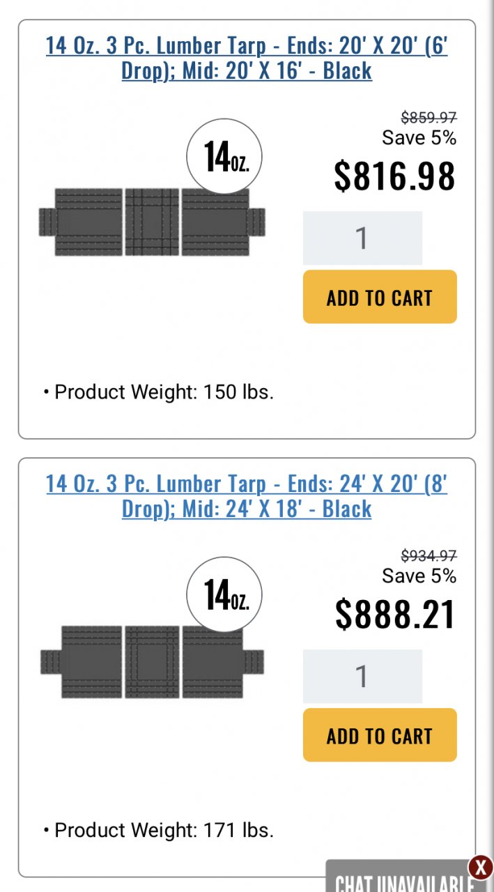

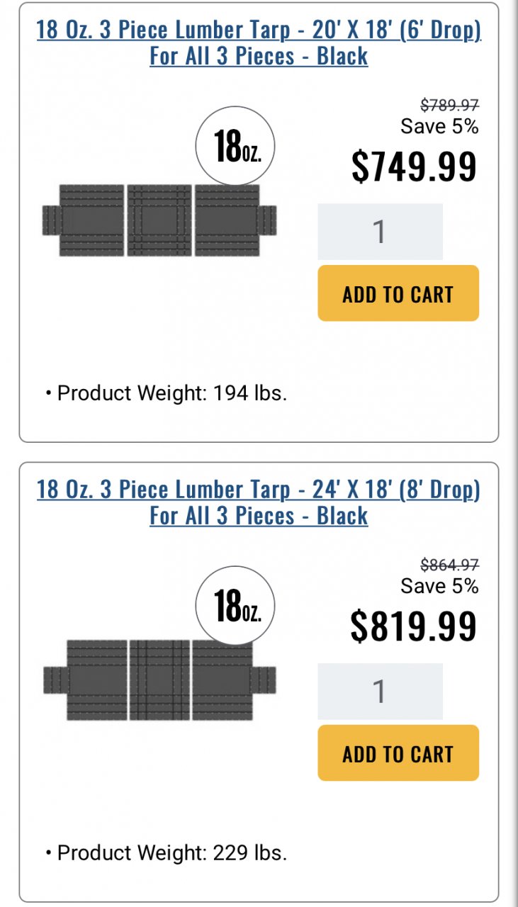

    I'd go with the 4 set pictured. Just to know it'll cover everything that isnt overdimensional that you may haul. The guys mentioning 6ft drops are right. Most ofthe time 6 footers are adequate. But to me, tucking that extra couple of feet of tarp on each side isnt a big deal. Not as big a deal as losing freight opportunities because you dont have 8 footers, and certainly isnt as big a deal as the freight claim could be from trying to cover an 8 foot load with 6 foot tarps.

    4' or 6' tarps. You'll get real tired of breaking out those 8s for short loads real quick.
