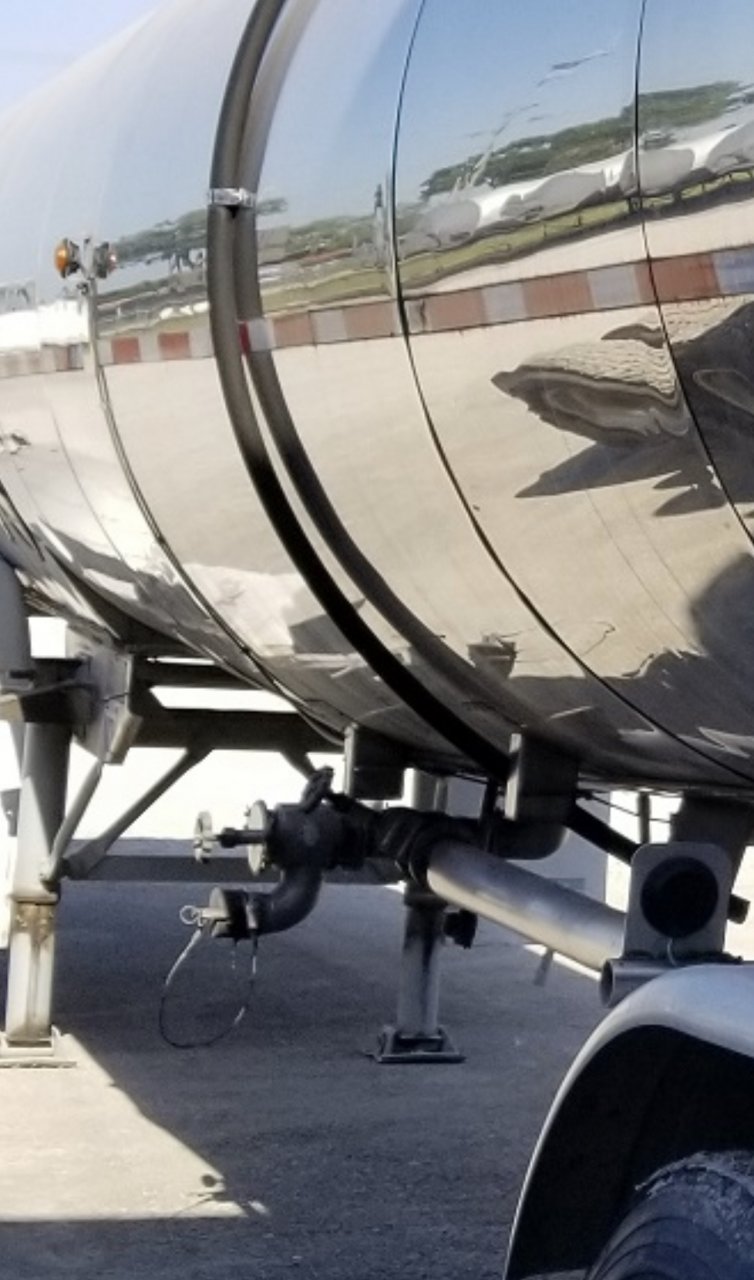

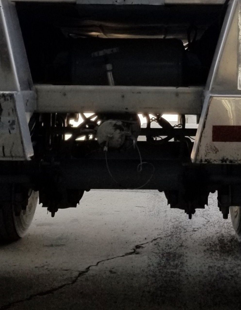

    F25AF57F-ADAE-466E-864C-9CB4FA024640.jpeg 75BBE3EF-2EEA-4958-8FB9-98C422F1F911.jpeg
    Cool!!! This is the trailer

    I've been doing this for s few and have only seen one trailer like that. More common is a rear unload with a pipe to the center. Usually has a "U" shaped fitting that goes between the rear external and the pipe. Looking at your pic I think it would take a pretty good grade before you would have a problem with heel. Tanker are expensive and if this trailer fits your needs, go for it. I would want it to have all of the tank inspections current first though.

    I agree I was thinking bout that so I’m going to request it

    As said above, if it passes all inspections, should be fine.

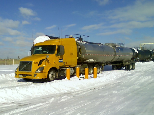

    B3FBCD97-D4BD-4886-8AB8-3D6AC8E47759.jpeg At McKenzie just about all of our true center tanks had a belly line. It worked great and the 16 years I worked there, never had a issue. We also carried six hoses on the rack in case we needed extra.
    As far as hauling different products, as long as you get a proper washout and documentation you should be good to go.
    PS. We also had product pumps mounted between the landing gear and a PTO shaft coming off the back of the tractor. We could unload anywhere anytime.
