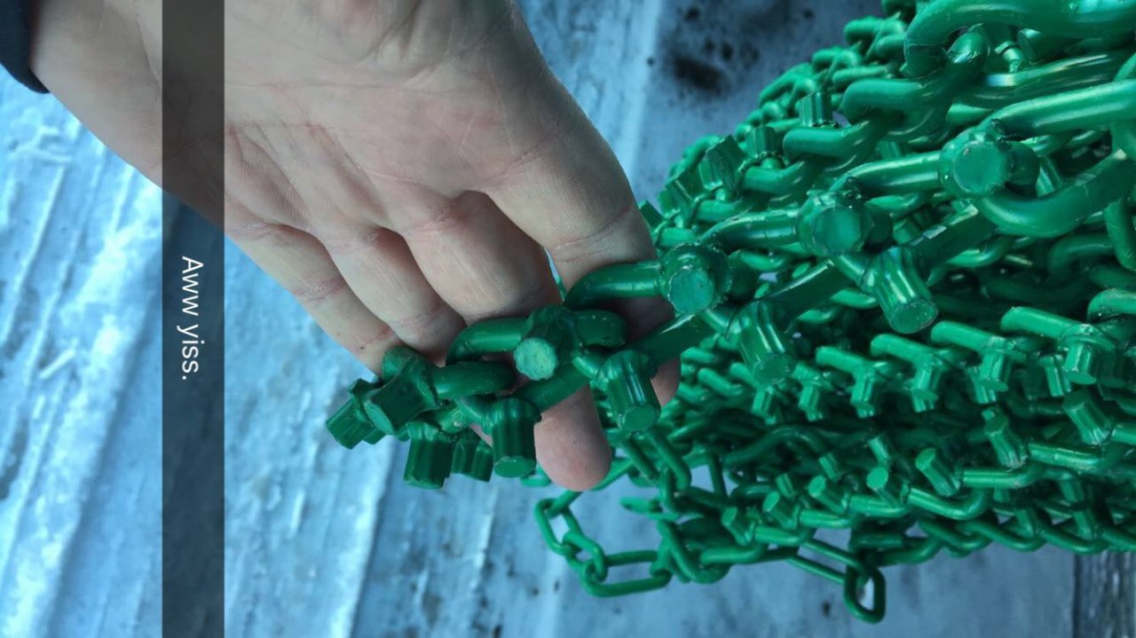

    Studded chains, they are typically for off-road or logging applications. Yes they are very expensive, we have a customer that sells them, on a lark I asked what they cost. IIRC, 4 yrs ago when I asked, 2 sets was around $400. The down side, they are not legal to run on the highway, dry pavement will chew the studs down, and at the same time, the studs will tear up the asphalt. In Colorado, if CDOT catches you running them on the pavement, they'll have you ticketed for them.

    I ran them for two seasons and they still looked new other than the paint was gone. Studs were still in decent shape going into this winter when I got out of that truck. I’d throw one set of 3 railers and get down the road. They were awesome.

    Wow. do they follow you to unchain later for that price??
