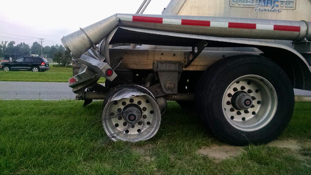

    thumbnail (1).jpg I had them on tractor and bulk pneumatic. Hated them on both. When your on a concrete highway when wet, oh the joy. I lost a SS on the trailer. Back passenger tire. Didn't know it until I saw the sparks from the steel belting. I DESTROYED the back of the trailer. The rim was square and the SS in front took a lot of shrapnel from the ture. It didn't blow, just went down from a bad plug that I had had fixed once before. The end result:
    new bumper
    two new tubes for the hoses
    one new rim/tire set
    one new tire
    new fender
    service call from a Love's truck and they brought the tire/rim set and new tire. All of this while loaded on the the slope of the road. 26 ton on one, damaged tire. Thank you no...
