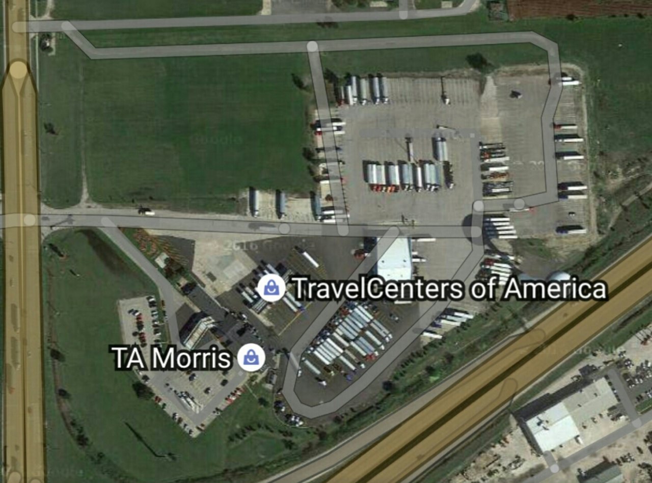

    For now you can just copy the longitude/latitude from google maps satellite view.

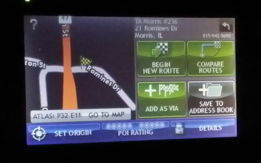

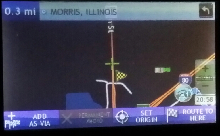

    Take TA in Morris, IL. Say that instead of going in the main entrance and dealing with all the mouth breathers by the fuel island, you want to go in the back way:
    So you plug in TA Morris into the RM and it gives you the default address:

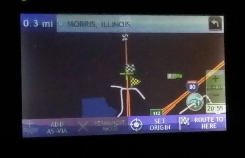

    Being the crafty trucker you are, you don't accept the default address and instead click "go to map" and move the crosshairs to the back entrance:
    You then click "route to here" and everything is hunky dory (if this is your only destination).

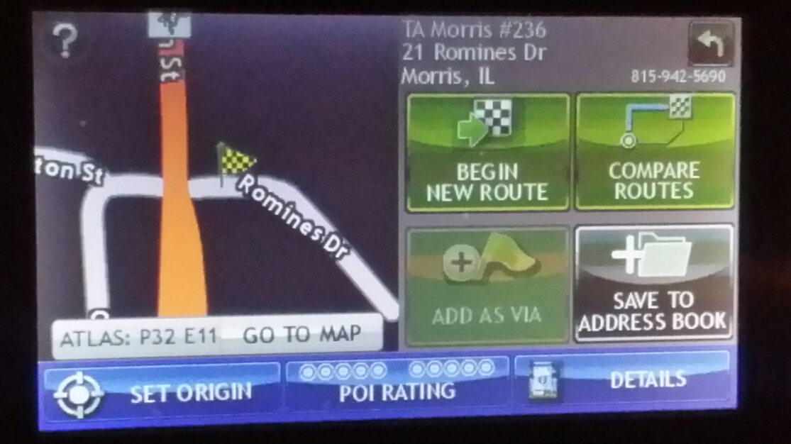

    Now do the same procedure, only using the TA as a via:
    (see how the "add as via" option is no longer greyed out)
    Click "go to map" again and move the crosshairs to the back entrance:

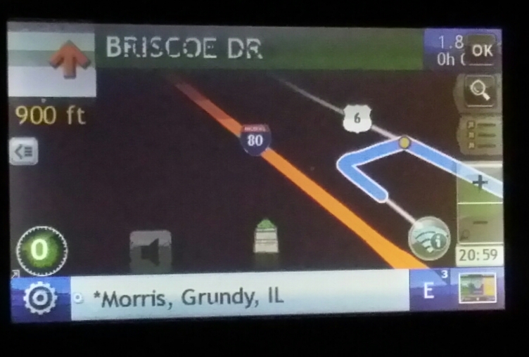

    Now click "add as via" and WTFbbq:

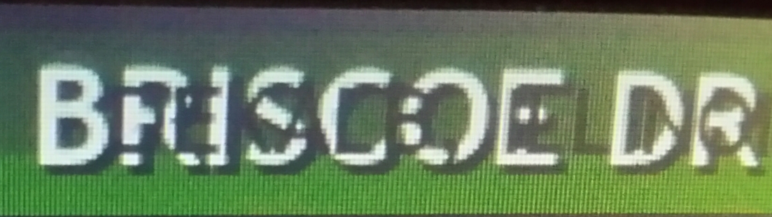

    (there is another screen layer on top of the expected screen -- note the "ok" box covering the distance).
    Black text covering the header:

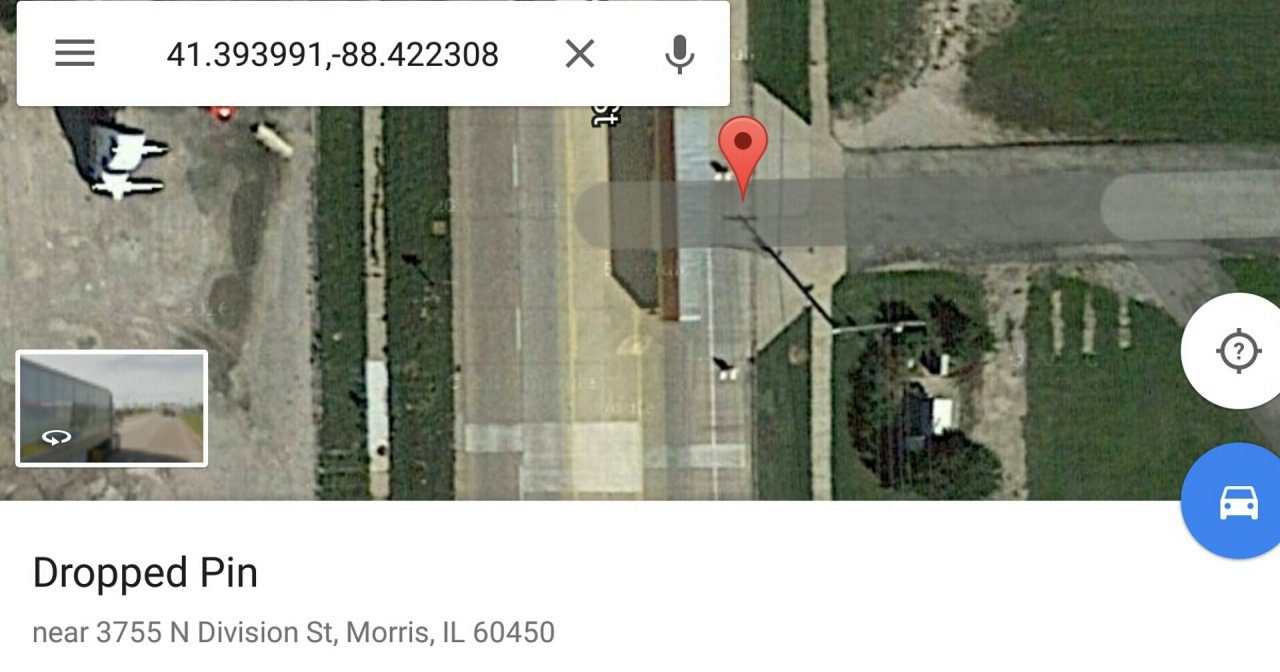

    Note that this does not happen if instead of entering the address first, you simply type in the longitude/latitude that google gives:
    Definitely a bug...

    RM tries to set the Truck Stop POI's to the fuel Island Lat/Long to correctly route you instead of to the business address in front.
