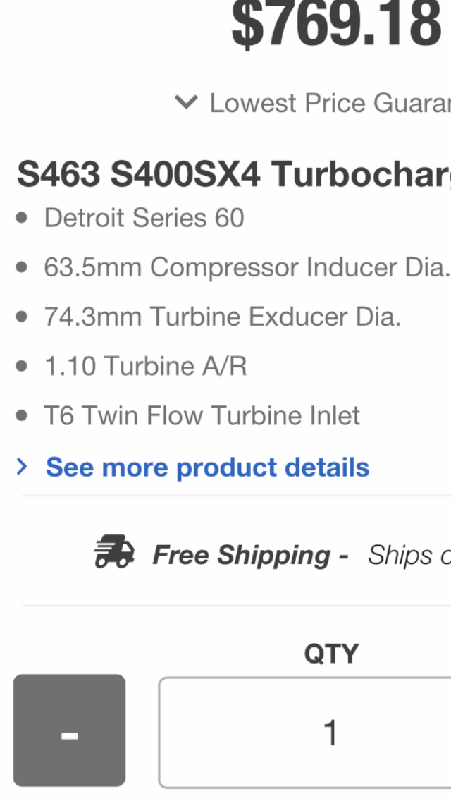

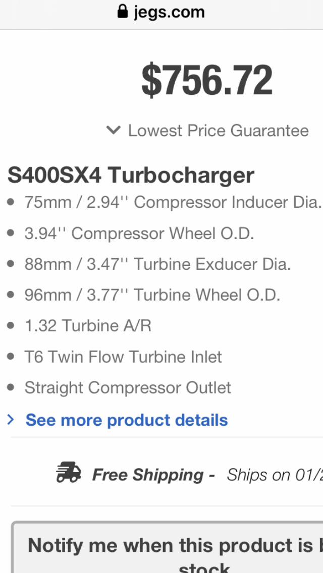

    5282006A-853B-4FD4-A79E-9E5495FBEC3D.png 34657451-49E4-4599-B307-3118C914C2A4.png A reman original garret can be had for $526 on sale currently at M&D distributors. A new B&W can’t be much more. Dave’s Turbo is a good source. I found the specs, courtesy Jegs. Obviously the smaller ones for the 11.1
    RubyEagle and blairandgretchen Thank this.

    Part# for 12.7- 171702. 11.1- 169012. Pretty sure that’s right.

    Those #s might be for non wastegated turbos. I think wastegated ends in 1. Either way make sure, depending on what he wants.
