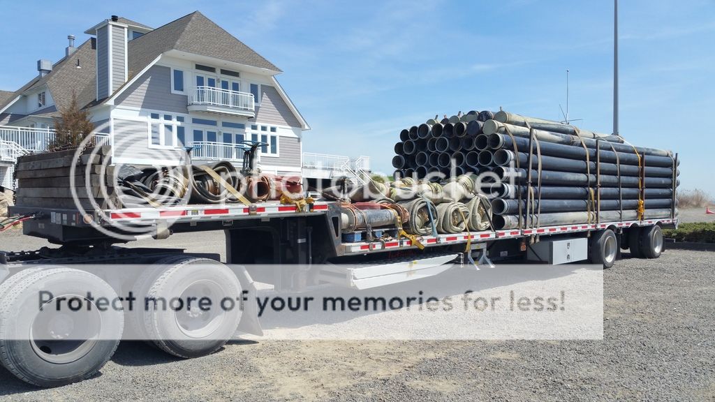

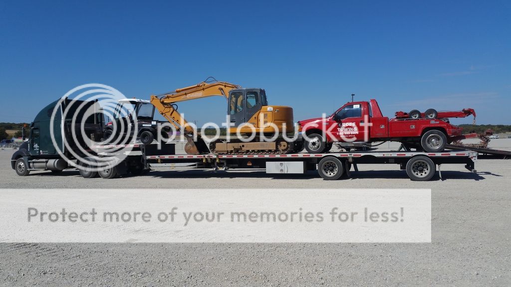

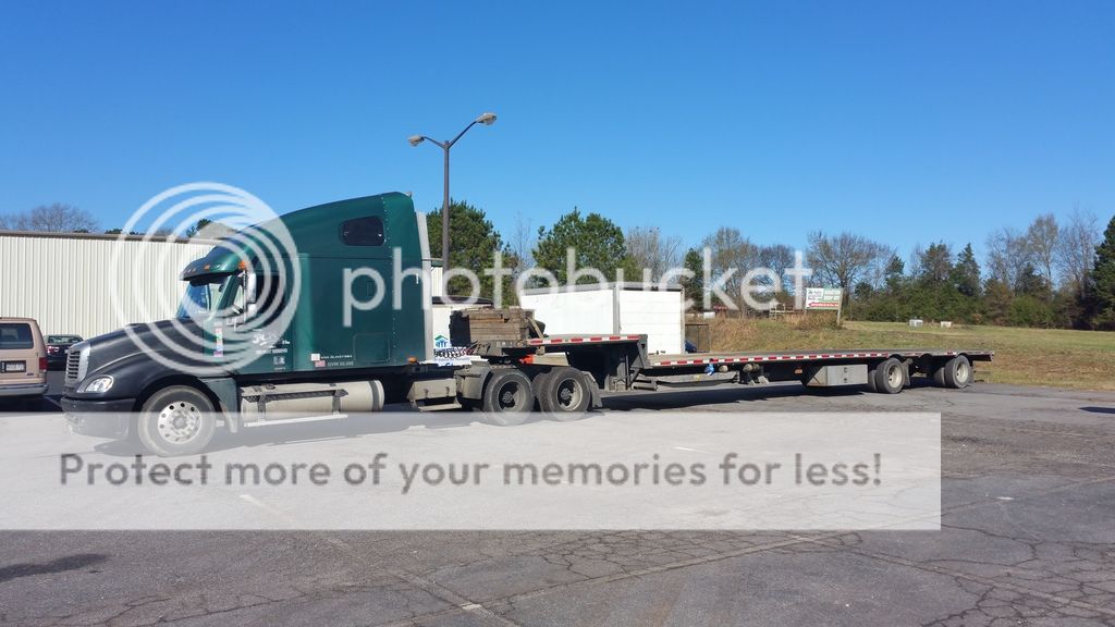

    My trailer is a 53' 2012 Fontaine Infinity.
    10ft upper deck, 43ft lower deck.
    18" king pin set back. 41.5' kingpin to center axle with the spread open.
    Tare weight of 11,400 lbs.
    Anything else, just ask.

    This type 53 has lots more useable deck with the longer heavy loads. They do make flats with the same wheel configuration, but what's the point? A 48flat has generally all the deck space you will need. However, if that Malone trailer had this wheelbase instead of the other, that pipe load would have been fine

    @Hurst
    Awesome photos... Thanks for sharing them with us... One question, on the back set of axles, there are grooves cut into the trailer but a few photos look like the axles can be set up in between the arches...
    Care to tell me more about how the trailer axles work and adjust? Thank you very much.

    The rear axle slides. Can be closed and operated as a tandem,.. or spread like you see in the pictures.
    Due to the 41.5' kingpin to center axle length when the axles are spread,.. it is technically not legal in Cali, Ct or Fl. In order to be legal I would need to close the axles to comply with bridge law.
    Florida is the only state to ever hassle me over it. It was only a $75 fine. They allow 44k lbs on tandems,.. I prefer to just keep it spread so I got the annual permit for $20.
