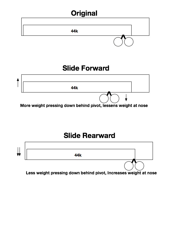

    This pretty much sums it up. Let's first assume we're talking about 53' trailers for those new guys who read this later. "Rules" only apply to "common load patterns". Problem is, where people get in trouble is picking up loads with UN common load patterns.
    Imagine a trailer that is loaded evenly with product back to about 35 foot, and this product weighs 25,000 pounds, then the last 13 feet is loaded with a heavier product that weighs 20,000 pounds. Any change in the "pivot point" is going to be greatly exaggerated as compared to the opposite arrangement.
    Trailer tandem position affects the FULCRUM point, but the real weight shift all depends on how the "load" (weight ahead of tandem center), and "force" (weight behind tandem center) is arranged in the trailer, which can vary anywhere form a little, to wildly. What we are dealing with is how much weight we are REMOVING from the drives based on the amount of weight (Force) that is situated behind the trailer tandem center.
    These "simple minded" pointers and "rules of thumb" are getting a lot of people in trouble and it needs to stop. WEIGH YOUR LOAD is the only to know for sure, or use any available weigh gauges to guesstimate. Where did they single any pallet(s)? Do you know? Is all the product pallet weight the same? Is the cargo load weight all even and evenly distributed from front to back? Do you know how many pallets for sure? If you don't know the correct answer to any/all of the above questions then you need to scale the load is the only way to know.
    Also consider ...

    To me it was always confusing to think of "sliding the tandems". The tandems are stationary, it's the box that you're sliding. The weight is in the box, so by sliding the box you're sliding the weight. If you need more weight back on the tandems, push the box back. If you need more weight up front on the drives, pull the box forward. Just slide the box where you need the weight to go. This was helpful to me when I was new.
