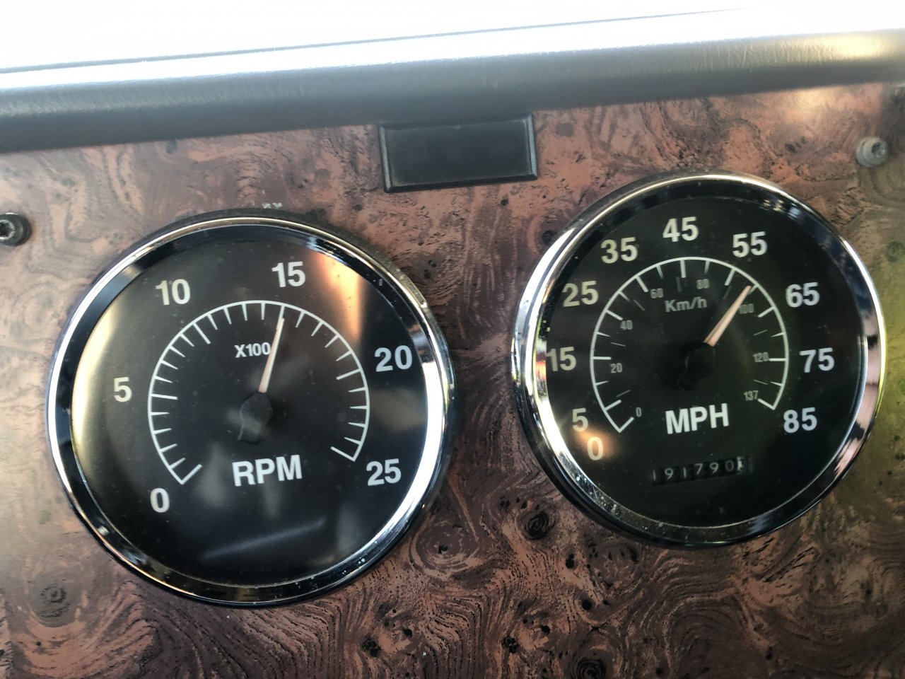

  4. Tug Toy
    Tug Toy Road Train Member
    7,118
    74,500
    Jul 4, 2015
    Corn field
    Direct with 3.08 and 295x22.5 rubber 98E41864-1B10-49CF-8BC6-AE251C0E0F2F.jpeg
    gekko1323 and Truckie6674 Thank this.

    at 1100 rpm your luggin it bogus no wonder all these newer motors are getting overhauled at 200-300k miles
    ajax1337, Bean Jr., Last Call and 2 others Thank this.
