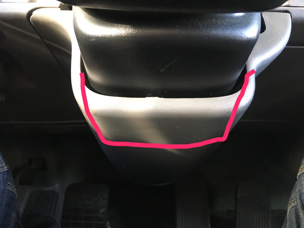

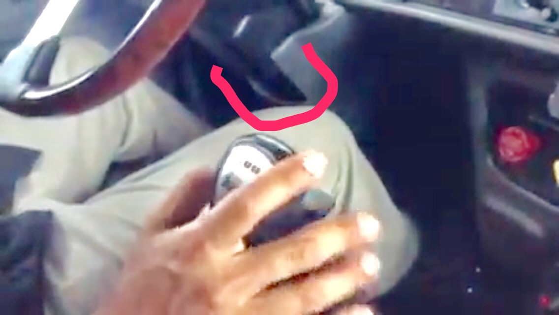

    I modified my first 386 steering column to give me a way better tilt and reach my spacing it away from the dashboard. I don't use air ride so I needed to modify it to get better control of the wheel at a more comfortable angle. I cut the plastic cover to clear the column. I just bought a 386 so I'll make a tutorial of how to do this. Heres a few pics of where I cut the plastic cover. Heres a pic to show how low the column went.
