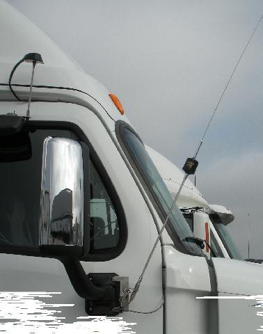

    Here is the picture......... finally. (My lean looks greater in this picture than what I remembered when I wrote the above. I also made a mistake when I said 45 degrees......changed it here, couldn't in the first post.)

    I did the same thing and am using some RG-58 coax from my 2 Meter rig I had. Getting about a 1.3 SWR and about a 5-6 mile range with it on a 09 Cascadia.
    My coax is about 25 feet long too. And home made

    Everything is a long way from perfect on these new trucks. So coax length does change the SWR. Doesn't solve the problem, but it will change the SWR making it safe to use your radio. You guys that keep scoffing at the coax length thing obviously don't do any installs on trucks with bad rf grounds.
