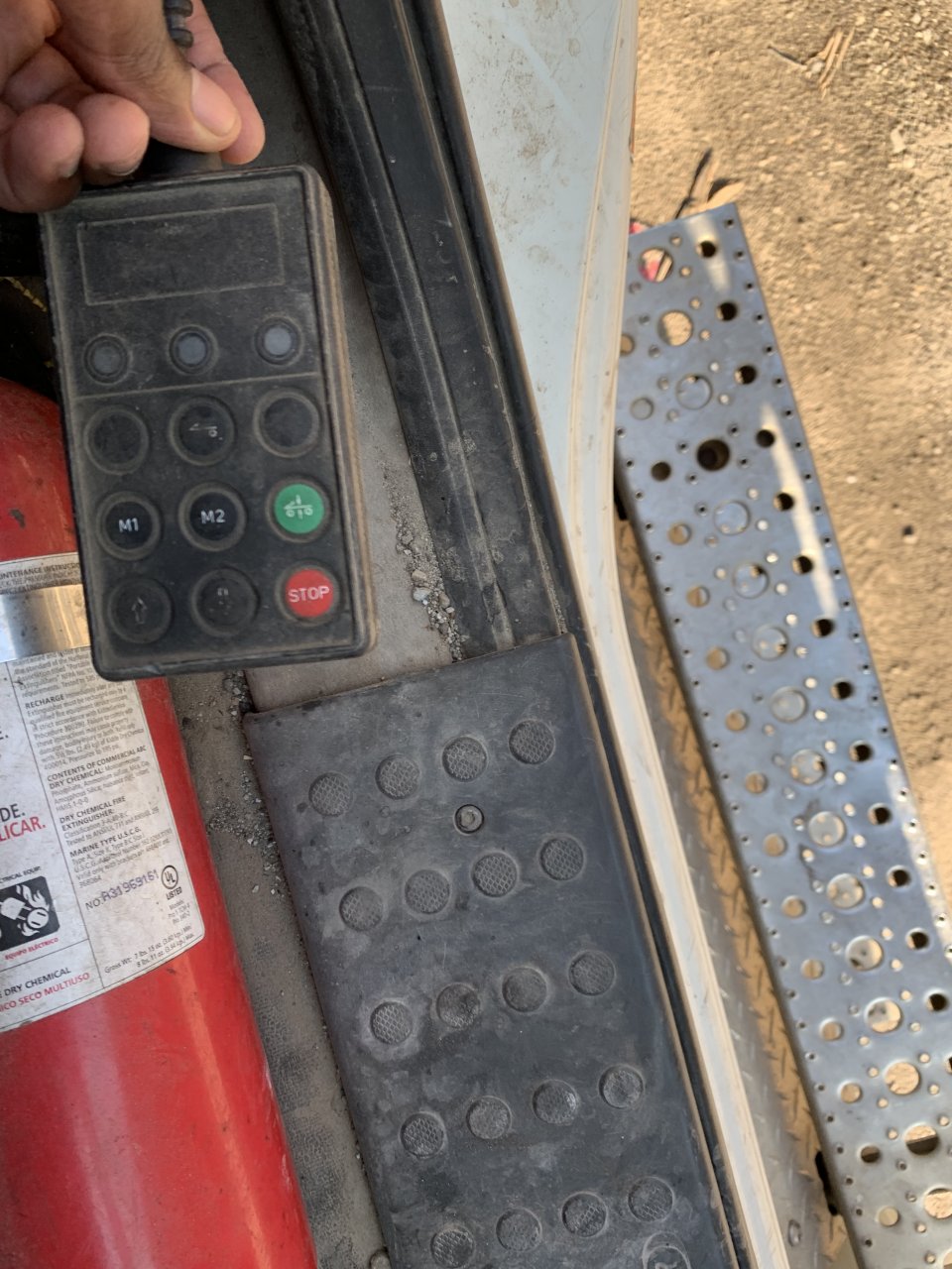

    Look for something like this under your seat.
    Top middle turns it on , up and down does just that and green resets them
    Intothesunset Thanks this.
