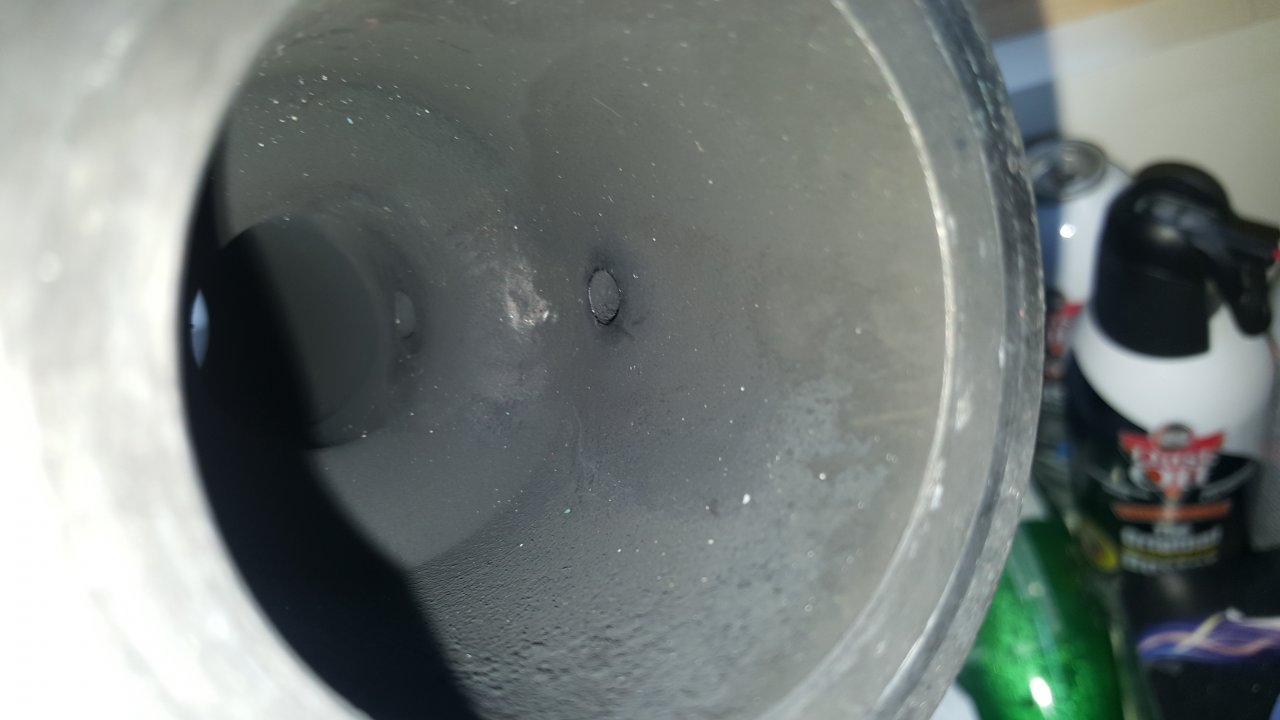

  8. Johny41
    Johny41 Road Train Member
    Joined:
    Feb 10, 2011
    Messages:
    1,192
    Thanks Received:
    1,020
    Location:
    Ontario, Canada
    I tried this, didn't work, the inner tubes are narrow curved hard to aces via sensor ports, maybe better from inside, get clogged with gummy soot , have rubber seals which can be damaged if you stick a sharp pin inside. See photos , i opened one after replacing.

  10. loudtom
    loudtom Road Train Member
    Joined:
    Aug 26, 2016
    Messages:
    1,717
    Thanks Received:
    2,801
    I cleaned the ports out with a stranded metal cable placed in a drill. It just happened that my hood latch cable was broken around the time I cleaned mine, so I clipped off a 5 inch section or so and it was perfect. If you can start the hole with a pick or something sturdy, then the wire will just follow the bends in the port until it comes out the other end. My venturi pipe is for a D16, so it is one piece without the "not a step" part.
