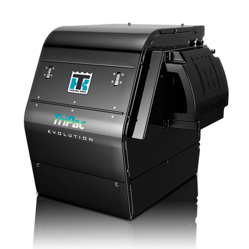

    I guess depending how you read that it could be misleading. A Tripac uses a bun heater for heat. It is part of the APU set up, buts it’s a separate unit and different manufacturer

    Thermoking tripacs usually have that set up. AC and cabin fan are powered by the APU and the APU will crank on to top off the batteries but the heat is from the bunk heater. Now the bunk heater does draw on the battery so you might hear the apu kick on but the thermoking does not draw heat from the apu itself.

    Okay so I'm confused if the bunk heater is a seperate system from the APU unit then when you change the oil on the outside APU unit:
    Then where is the unit that you have to change the oil/filters etc. for the bunk heater? Because if the bunk heater is a separate unit from the APU than shouldn't there be two units of the attached imaged on the back of the cab instead of just one unit?

    The clue is in the name. TRI-pack
    1 Diesel fired Bunk heater
    2 Ac conventional refrigerant system powered by main unit
    3 Apu providing electricity/engine heat
