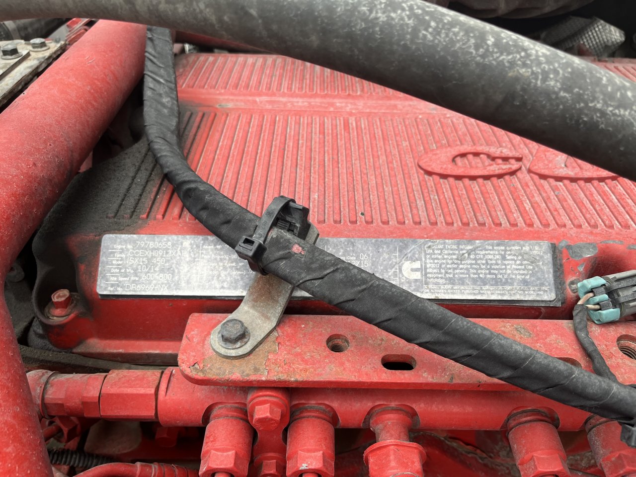

    Thanks for the advise you guys have giving me thus far believe me im using it. The cascadia is out the picture. Couldnt see the 2.41 being beneficial. I drove the Volvo today. It has a cummins which i pictured and a 2.58 but non emissions. I made a mistake with the inspections as they were from over a year ago so lets kinda disregard them. The test drive was decent. There were about three drives that needed replacing but the truck slid twice on me. the first incident I had been coming down a decent overpass and couldnt get it in gear due to what seems like something with the clutch brake when it began hopping. For me I thught it was the brakes at the time and could be because it wasnt that wet at all. i hopped the curve a bit no big deal. maybe three bad drives could do that? On my way back im approaching a red light and i thunk to test the brakes again so I do a semi abrupt brake and this time it got sorta dangerous as it vibrated with the clutch pressed so in neutral. Could it be the brakes overly sticking or something. They are drums but it was kinda odd to me. As far as dash light both the check engine and the abs lights are illuminated. the seller IS actively working the truck though. He just did a load and was on his way to another so how bad can it be? he sent me ath edash diagnostics which had no faults. maybe someone might know better but if its a 2012 volvo with a non egr motor wouldnt that mean its not the original and therfore possibly not show any faults but thats just my opinion. And correct me if im wrong but the onboard is far from an ecm dump right? i plan to call cummins and see if theyll run somediagnostics before I make an offer but im thinking id rather replace a rear end rather than ever deal with the emissions, right? thats it, its interesting but im can anyone suggest a problem brake issue that i wouldnt want to get into?

    2012 is an emissions motor. Anything 2010 and newer are emissions motors. You seem desperate, who knows why. Goodluck.
